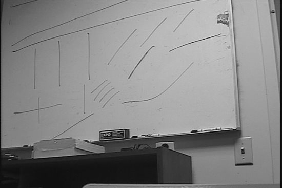

I am using DVSDK 4_02_00_06 to write a DMAI application that captures NTSC D1 composite video on a DM365 through the LI-VI365 board.   I set oper_mode=0 int eh boot args.  When I set my Capture_Attrs to give me UYVY frames, ontheFly=FALSE I get an image that looks like this (720x480 - I removed the color data):

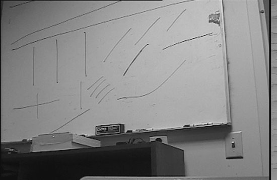

That image looks fine.  But I need 420PSEMI to feed the H264 encoder.  So I set my Capture_Attrs to ColorSpace_YUV420PSEMI, ontheFly=true, resolution left the same.  That gives me this image (again color data removed, this image ends up 736x480, after padding):
Notice how the slanted lines are jagged, and stair steppy?  It's almost as if the resizer is duplicating fields rather than deinterlacing the video properly.  Why is this?  How do I setup the Capture / Resizer to give me an image that looks like figure 1, but in YUV420PSEMI for the H264 encoder?  Is it possible to get a full frame of YUV420SP directly from the capture device (ontheFly=false?) and bypass the resizer, like I assume the UYVY capture is doing?

  • I eventually got an acceptable 420PSEMI image using single shot mode, not continuous (set oper_mode=1 in the bootargs to use the resizer in singleshot or onthefly mode).   In continuous mode the capture driver duplicates a field, so you lose half the vertical resolution.  This was documented in the driver document somewhere.  So in a sense you lose half the vertical resolution, but keep the full horizontal resolution, and get the stair step look on diagonal lines. There are two ways to fix this.
    Option 1, if continuous mode is needed (better performance)  modify the driver code to pass both fields into the resizer.  I've seen posts in these forums that mention what needs to be done, but I can't find them right now.  I did not go this route.  I got acceptable performance using option 2.
    Option 2,  use the Resizer in "onthefly" or "singleshot" mode.  I capture the full resolution UYVY image, and send that into the resizer to get a 420PSEMI output.  The trick here was configuring the resizer properly (getting the correct image width, height, linelength values).   And I may or may not have had to change the Resizer.c file in the DMAI library.  I also may or may not have changed the driver code in the kernel.  I honestly can't remember.  I tried so many things, and finally got something that worked.  Here are a couple threads about capturing full resolution images that got me started.

    And some warnings.  Due to the nature of NTSC video, when I started using both fields I got very noticeable combing artifacts on objects in motion.   I believe this is why whomever wrote the driver decided to line double.  The half vertical res (line doubled) images may actually look better (and encode better) than video with combing.

    1.  Capture UYVY images (oper_mode=0, cAttrs.ONTHEFLY=false).  Dumped these to a file to prove they looked right.  The image from the first post is an example output.
