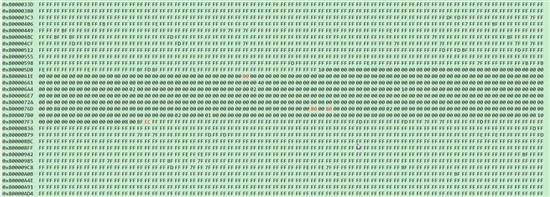

another problem ,
I 'm debugging the program with CCSv5, after I configure the EMIF, then open the memory window,it was located in the mddr space and enable continuous refresh button, found that some bytes changed at every refreash time, and if I change the value of an address, the value of other address also changed, not a specific address, I have test a lot of times,
most of the contents are 0xFF.
which registers should i adjust?

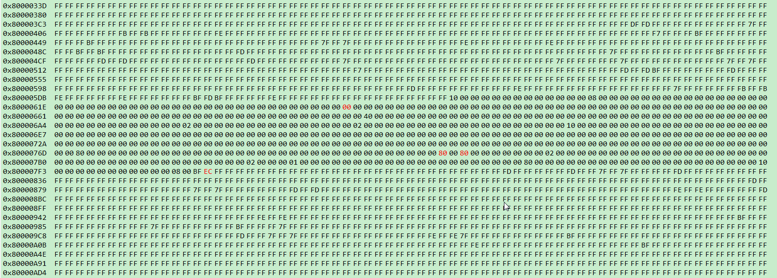

I have followed the tips,followed the caculate tools, seed spreadsheet. but still got the problem
the following is the picture of the momery. The red indicates the changed(because I have enable the continuous refresh) ,the address changed was randomized,
And if Changed the value of somewhere, the value of other place may be changed, this is what i saw.

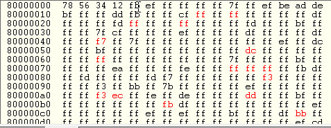

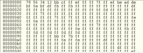

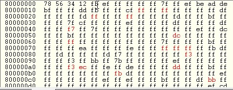

I try to use different SDRAM drive strength, see the following picture:
FULL drive strength:
I have write the 0x12345678 to 0x80000000 and 0xdeadbeef to 0x8000000C.
the red shows the change between a second before, I think FULL drive strength may be better than 1/8 drive strength, because in am335x-evm, after initial the DDR2, the contents are different each other,it couldn't be 0xFF mostly.
Is that right? how to improve the drive strength?
