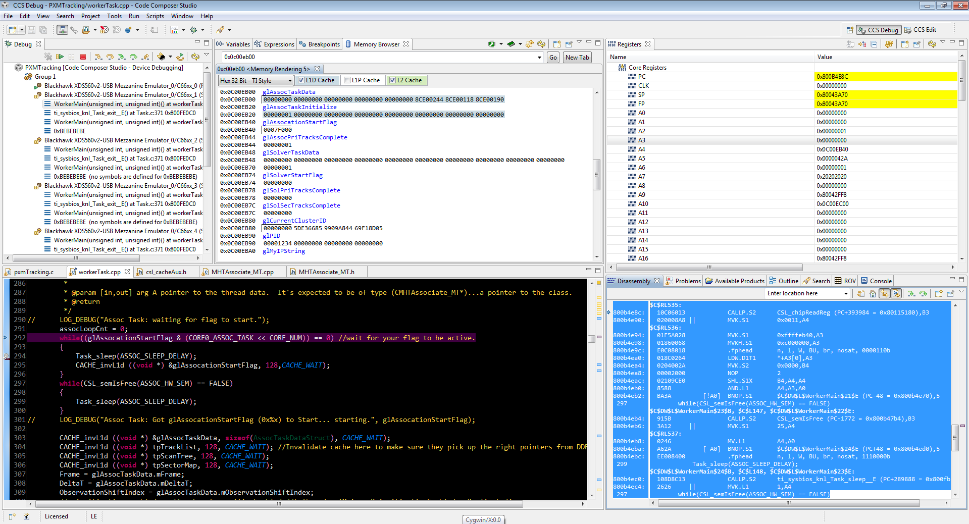

    Screen 1:
    Shows the flag as zero right before the function sleeps.

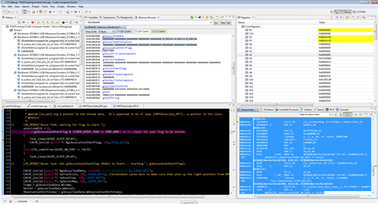

    Screen 2:
    Shows the flag as 0x0007f000 before the comparison

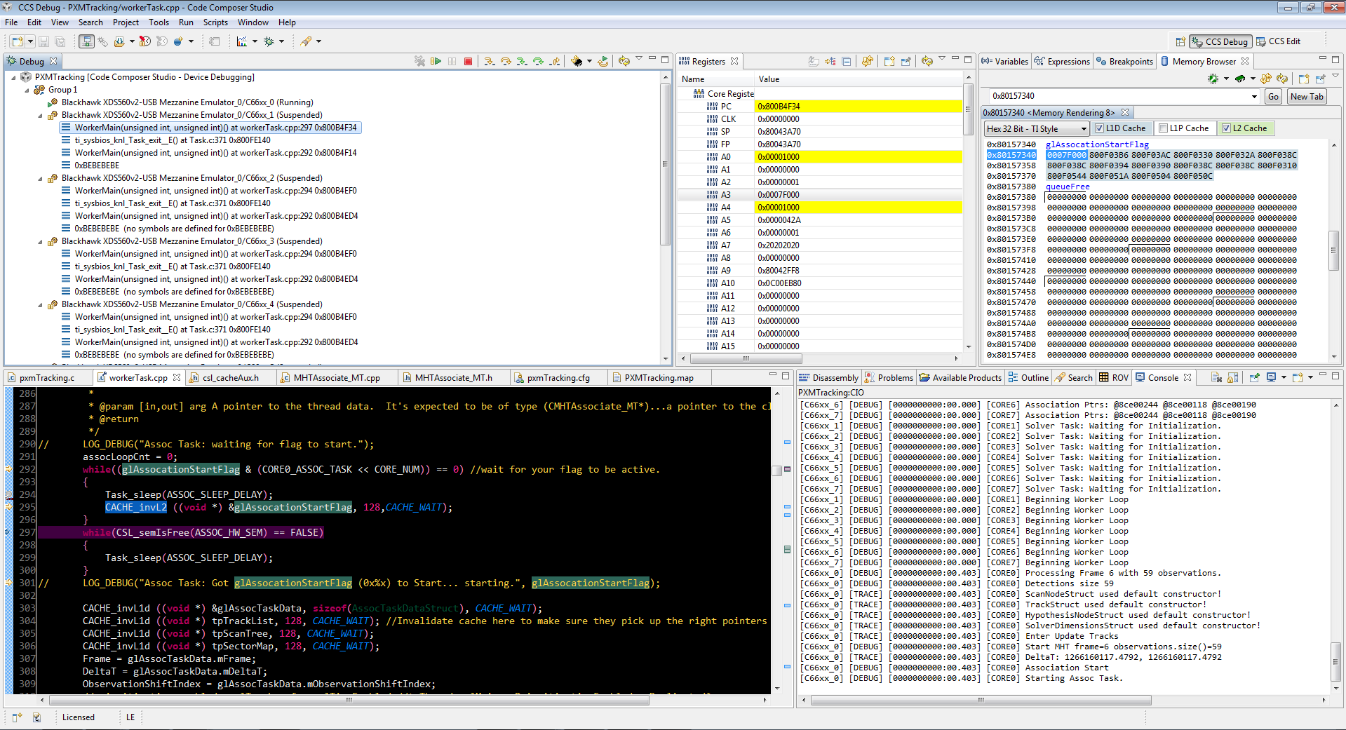

    Screen 3:
    Shows the flag back to zero.

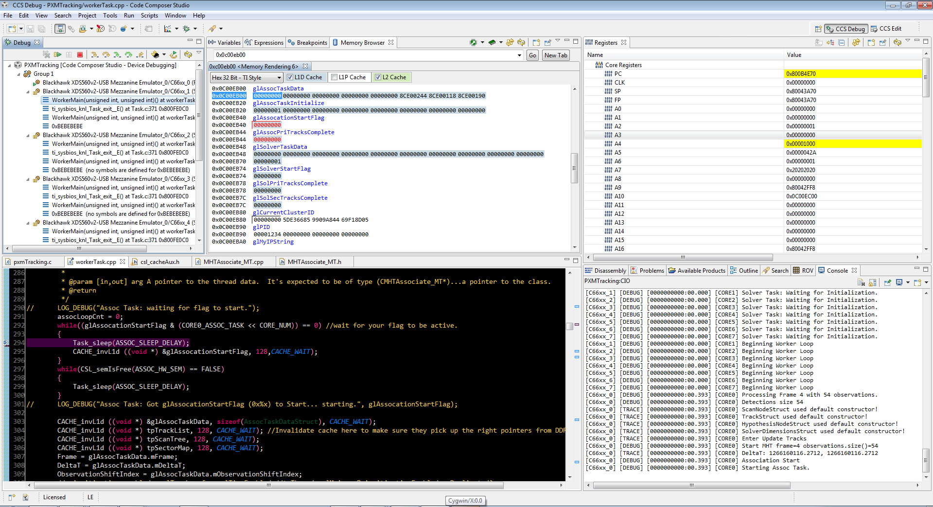

    Screen 4:
    I over wrote the variable manually with 0x0007f000 and then the while loop exited.  You can see the change this time in the registers.

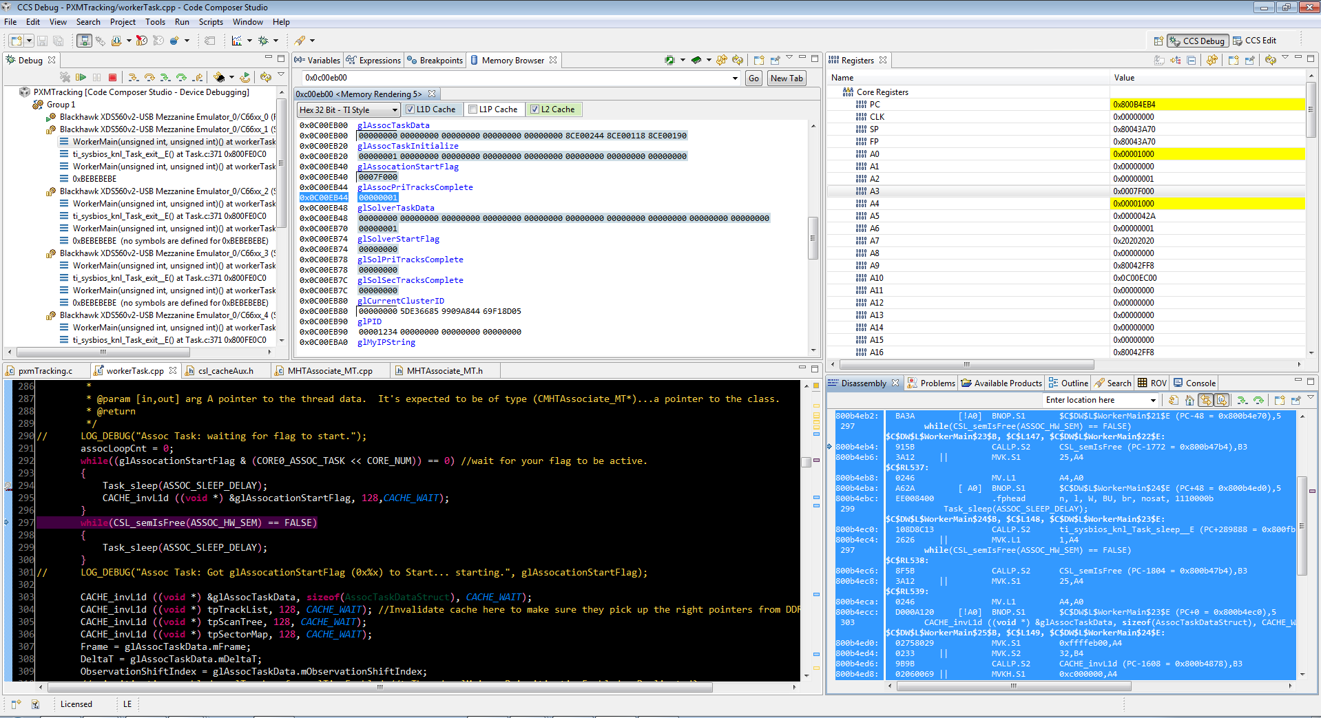

    Sorry about all the screen shots.  Its like the cache invalidate did not work.

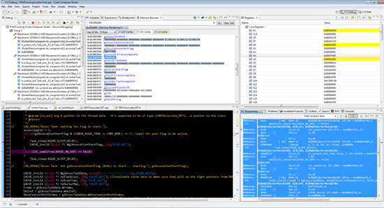

  • hi Steven,
    If I move the varible to DDR3, it works just fine.  Here is the screen shot:
    It must have to do MSMCSRAM.  Still trying different ideas, but suggestions would be great!  I don't want this variable to be in DDR3 since it is polled so often, I would like it on board.
