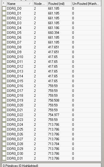

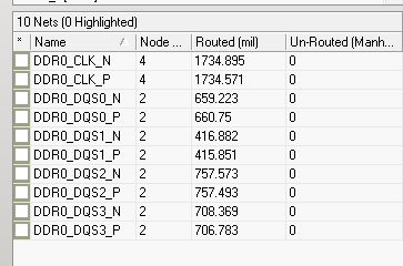

    Currently we are working with the following design topology
    Trace Length (inches)
                         Byte 0    Byte 1    Byte 2    Byte 3
    CK trace       1.8       1.8          2.5         2.5
    DQS trace    1.8       1.53        1.33      1.21
