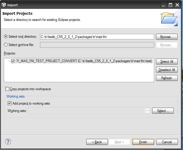

I'm working on a C5515 EZDSP usb stick with CCS 5.2.1.
Trying to integrate a soft-modem utilizing the modem part of TI's FAXLIB
So far, I've been tweaking settings and changing paths but haven't been able to get the examples running.

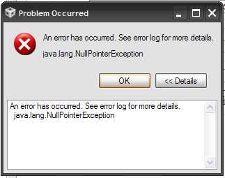

    Here is what I did:
    I receive an error about "make"
    I change from "make" to "gmake" (I assume this is correct?)
    Now, when I click "General" in the properties, I get this error:
    When I try to build, this is the console output:

    I see that some of the paths there are wrong. Is that part of the problem? How do I fix that?
