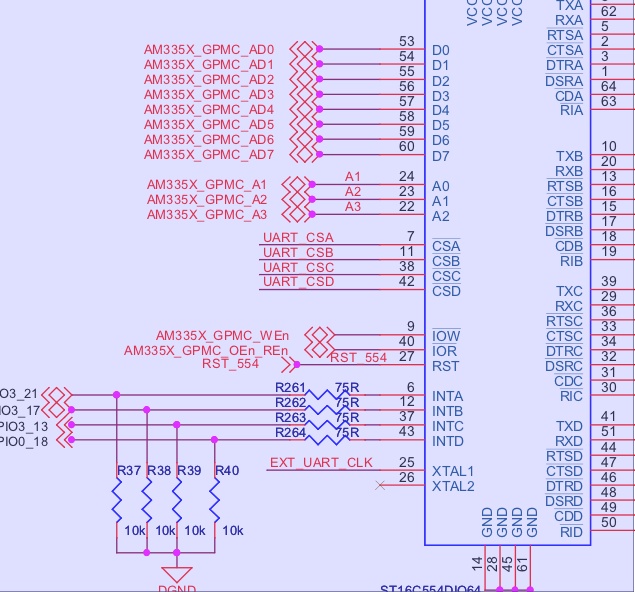

I drive a st16c554 with am335x gpmc port. But I'm stuck at the gpmc_timing.
I set the gpmc at 8bit non-multimux asynchronous nor flash mode. Is this correct?
now my problem is the st16c554 can't be detected.  I suspect the gpmc_timing is not correct.

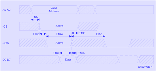

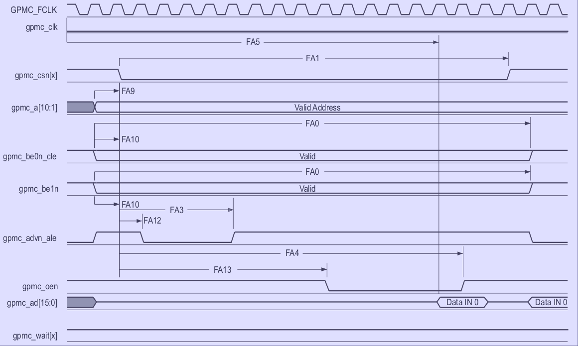

and I'm puzzled by the timing diagram ( I found it in the SPRS717D document figure 5-18):
all the timing is based on CS_ON point except DATA signal. but what the time gap between start of FA5 and CS_ON?
I need that value to set DATA signal timing based on CS_ON.
And another question:

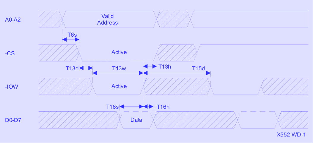

How to set DATA hold time? below is the timing chart for st16c554:
beside DATA hold time T16h, I don't know how to set T15d use the formula provided in sprs figure 5-18.
