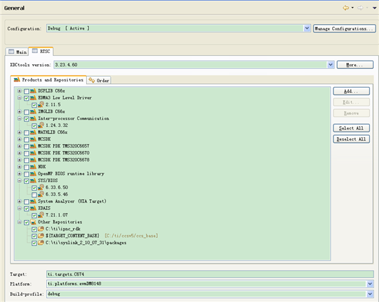

I find the BIOS_c6xdsp.cfg have the following code:
xdc.loadCapsule("mcfw/src_bios6/cfg/ti814x/SYSLINK_common.cfg");
If I should build the syslink in the windows with CCS v5.
I try create a ccs project according to the web site: http://processors.wiki.ti.com/index.php/Creating_CCS_Project_for_SysLink_samples.
However, I can't find the platform "ti.syslink.samples.rtos.platforms.ti814x.dsp".
What should I do if I want to run the dsp code with CCS v5.
Thank you

    I uncompress the tar.gz file into a directory of C:\ti in windows XP, and config the CCS as follow:
    However, when I edit the cfg file, add the "var Syslink                 = xdc.useModule ('ti.syslink.ipc.rtos.Syslink');" in it, and build the ccs project,
    the error as follow:
    C:\ti\syslink_2_10_07_31\packages\ti\syslink\ipc\rtos\package.xdc found along the package path, but no schema file was found. Ensure that the package 'ti.syslink.ipc.rtos' is completely built.
    What's the mean?

    I read the code of IPNC RDK, I find some "link" between C674x DSP and the M3. I guess the communication between  DSP and  M3, or  DSP and A8,  is used by link, and the link API may be the syslink or IPC. I want to know if the A8 used syslink, the DSP must use the syslink too. What can I do when the DSP use the syslink. If I must debug in the linux?
    Now, I can connect to C674 DSP,  and run the "Hello world" using ccs v5. My problem is that I want to know if I can run the syslink in the dsp using CCS. I download a ccs project of syslink samples on the web https://github.com/vanti/Syslink-MessageQ-sample-CCS-project/zipball/version-1.00.00.00, however when I build the project, I have the error as follow:
    Could you give me some advices detailed.

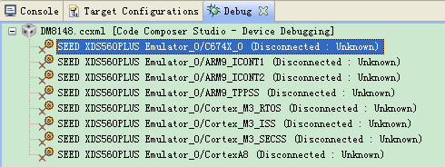

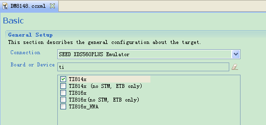

  • Hi, Narayanan
    I am so glad that I have connected the DSP using CCS successful, and I can run the A8 and M3 successful.
    Now, I have some questions about debugging the DSP.
    1, when I run the DSP, it will suspend and I must continue run it. My steps as follow:
         1) Create a new Target Configuration File, and configure it as follow:
         2) Launch the selected configuration, as follow:
         3) execute the "load.sh", make the DSP out of "reset"
         4) Connect the C674x DSP
         5) Execute the system_server  to run the A8 and M3,
         6) Load the executable file of DSP through "Load Symbols" in CCS
         7) Run the DSP
          when I run the DSP, it will suspend, I must continue click F8 to run it.

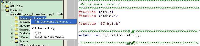

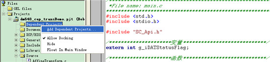

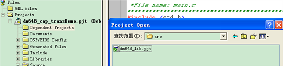

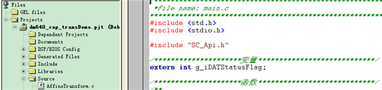

    2, When I using CCS3.3, I can open and debugging a lib project as follow:
           1) open a project of ccs3.3
             2)open the lib project as follow:
              Then I can debug the lib source.
              Though I can't debugging the source code of dsp as a project, could I add a lib to the IPNC_RDK and debugging the lib as above.
              I will also try that, since I using the Davinci device and Linux OS first, could you give me some suggestions about developing the Davinci device.
             Thank you very much.
  • 1, when I run the DSP, it will suspend and I must continue run it
     - Do you mean once you connect to DSP, load symbols and give "Run" it halts automatically. At which point does it halt. If you run again using F8 does it run continuously or does it halt again ? Note that connecting to the DSP will halt the core and that is expected. You should give run first time.
     - If you just want to add the library source files for single step and debug, you can do
    Select the edit source lookup and add path to your library folder. This will enable CCS to select files from your library if it halts at one of your library functions.
    Pls also try posting your query in CCS forum. The CCS experts monitor that forum and will be able to provide better advice

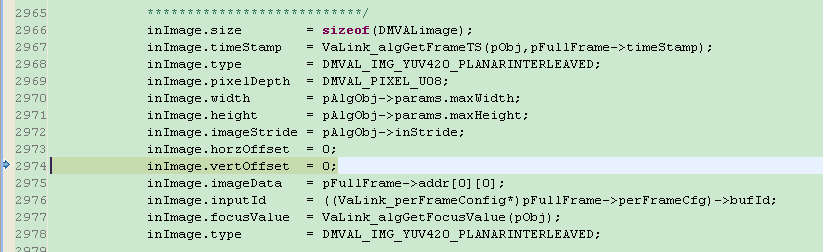

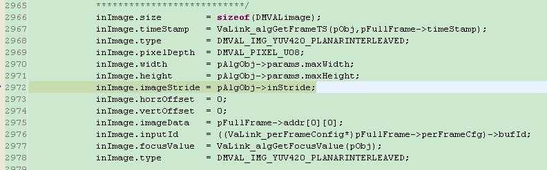

  • Hi, I can load symbol and run the code of DSP side successful.
    However I have a question.
    I execute the code by step, however, I find it can't execute as my expect. I guess it execute as the asm code, what should I do if I want it execute as C code.
    As follow:
    First step, it run in the line 2974. But the second step it run in the 2972.
    The first step
    The second step
  • This is due to compiler optimization .If you want to completely disable compiler optimization modify:
    /dvr_rdk/makerules/rules_c674.mk
    Change
    CFLAGS_INTERNAL += --symdebug:dwarf -O3 -ms0 --opt_for_speed=5 --optimize_with_debug
    to
    (Remove -O3 -ms0 --opt_for_speed=5 --optimize_with_debug)
    Note that this will have a major performance impact. Use it only for debug during development time

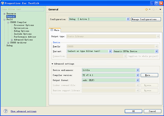

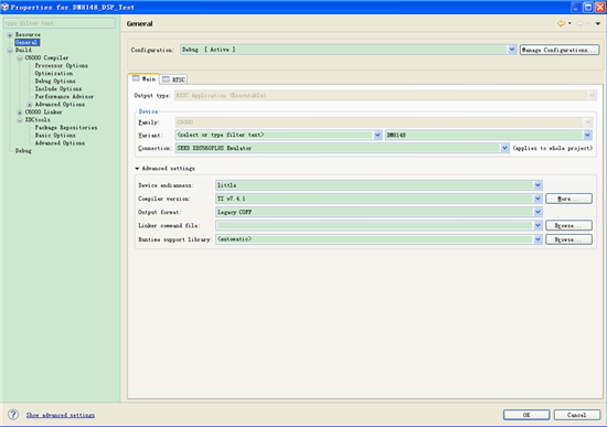

    I have a question about creating a lib for the C674x DSP in the DM8127.
    Could I create a C674x static lib on the Linux OS, what should I do?
    And I create a C674x static lib by using the CCS v5.2 on the Windows OS, as follow:
  • Do you mean your development host is linux and you want to use create a c674 static lib ?
    The TI c6x codegen tools are available for linux also (part of RDK package) and you can use it to create lib.
    ar6x is the tools which can be used to create libraries
