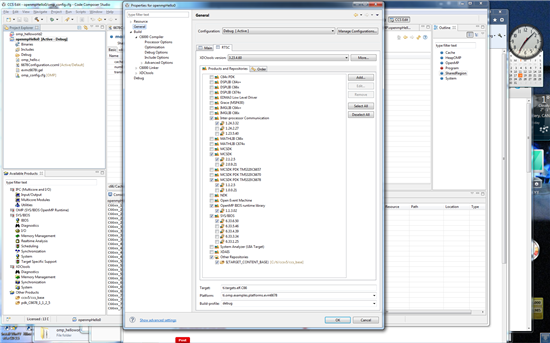

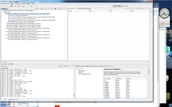

I try to run the simple openmp hello world example. After launching the project to emulator 560v2 in the EVM6678, it is in a running status, see below figure:
The core0 stops while core 1, 2 and 3 are running, core 4,5,6 and 7 seem no loading code. This does not look like the normal launching case. Of course, there is no correct echo message in the console window.
The tools used are shown as:
I have no idea what tool may be outdated or not.
This is the echo message when launching:
C66xx_0: GEL Output: Setup_Memory_Map...
C66xx_0: GEL Output: Setup_Memory_Map... Done.
Connecting Target...
C66xx_0: GEL Output: DSP core #0
C66xx_0: GEL Output: C6678L GEL file Ver is 2.004

They are righ?
I have used the GEL as the link said:
http://e2e.ti.com/support/dsp/c6000_multi-core_dsps/f/639/t/199072.aspx
I check the .cfg file and do not see the setting to run the core number (4 loading code above) yet. I do see there are 4 threads in the main().
I do not add a link cmd file yet. If it needs, which one I can use?
    The CCS version is V5.2. Windows 7, 64 bit. After launching, core0 stops while core 1,2 and 3 running. This is not with other projects that wait for running after launching.
    Here is the compiling message. There is a warning like message about package:

    Whether I should update the .cfg file or not? If it should update, then what else I can do?
  • Excuse me. Please ignore previous post. It is not accurate information.
    The compiling error is this:
    Description Resource Path Location Type Cannot read property "base" from undefined omp_config.cfg /openmpHello0 Configuration Validation XDCTools Configuration Marker
    Description Resource Path Location Type Cannot read property "base" from undefined (C:/Users/Jeff/workspace_v5_1_OPENMP/openmpHello0/omp_config.cfg#44) omp_config.cfg /openmpHello0 44 C/C++ Problem
    line 44 is:
      SharedRegion.setEntryMeta( 2,
                                 {   base: heapOmpMem.base,
                                     len:  heapOmpMem.len,
                                     ownerProcId: 0,
                                     cacheEnable:
    true,
                                     createHeap:
    true,
                                     isValid:
    true,
                                     name:
    "heapomp",
    What is wrong with the new .cfg file? Thanks.
