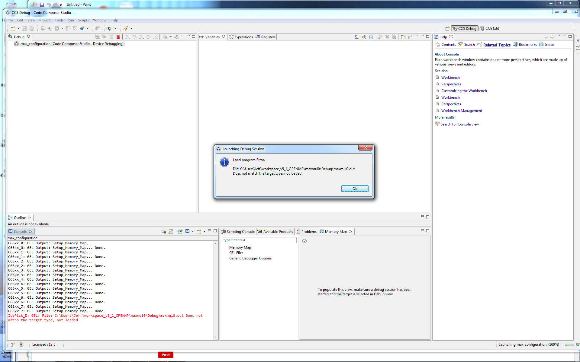

IcePick_D: GEL: File: C:\Users\Jeff\workspace_v5_1_OPENMP\maxmul0\Debug\maxmul0.out Does not match the target type, not loaded.
And there is a message box:
Does the gel file not match the platform file ? I am puzzled by these options. Could you help me? Thanks.

    I try to run OPENMP examples on C6678 EVM. There is a platform option at RTSC. It is: ti.omp.examples.platforms.evm6678. Now I use the companying EVM6678 gel file: evmc6678l.gel. When launch the project to emulator, it echos:

    I think the issue is due to the mismatch of the output file and your target configuration (emulator configuration). The test case loading is completed by a GEL function, but it is not related to your GEL file "evm6678l.gel".
    May I ask which project you are testing and could you check the build property of your project to see if you are using the correct C66x compiler and endianness?
    And please check the target configuration file (.ccxml) to see if you selected the correct emulator and device, such as "TMS320C6678".
