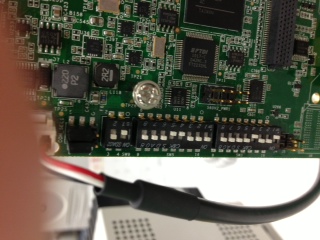

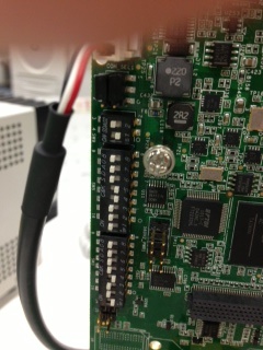

I updated the latest IBL on the C6657 board of the EP side and set dipswitches as below.
LENDIAN=1 System is operating in Little Endian mode
BOOT[3:0]=0100 (PCIe boot)
BOOT4 Reserved =>0
BOOT[8:5]=0000 32bit
BOOT[9]=0 100MHz
BOOT[12:10]=011 100MHz
PCIESSEN=1 1 = PCIe module enabled
PCIESSMODE[1:0]=00 PCIe in End-point mode

    I've reviewed the switch settings and believe them to be correct to boot EVM #2 into PCIe-EP as follows:
    SW3 (1...8)     OFF ON  ON  OFF ON  ON  ON  ON
    SW5 (1...8)     ON  ON  ON  OFF OFF ON  ON  ON
    There was no guidance for PCIESSEN (SW9 Pin 1) so I configured to be enabled as follows.  Correct?
    SW9 (1...2)    OFF ON
