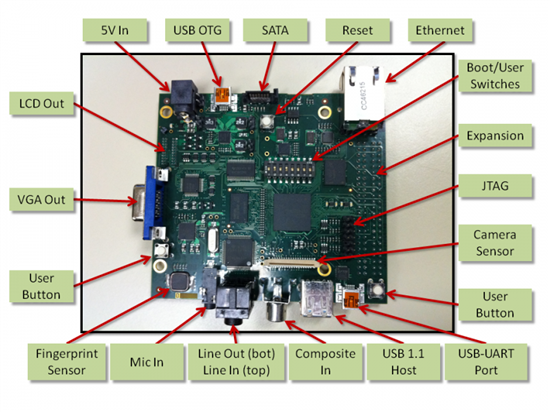

How can I check the output waveform of C6748 LCDK in an oscilloscope?
Is it from the Line Out?
If so, then an adapter from 3.5 mm jack socket to BNC is required?
Thanks.
PP

If you want to check the Audio output, then need to check this in LineOut signal.
Please download the schematics of this board, in AIC3106 chip page (page no 10/12),
check the pin numbers for digital lines, analog lines and can probe the signal in these pins.
In resistor ends also, you can probe the signals.
