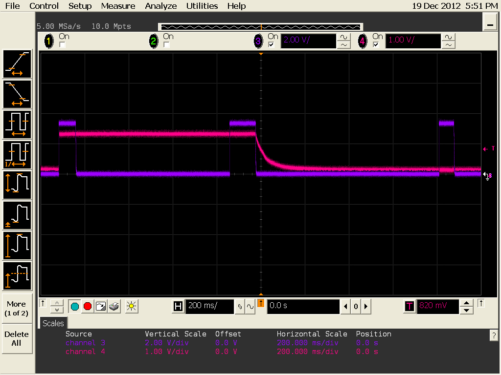

C5515/C5535 did not wake-up from "RTC only mode" in case of continuing input the wake-up signal  many times.
※I confirm this issue by using C5515EVM and sample code and captured the waveform when this phenomenon occurred. Please check the picture which I attached to this forum.
* Bule line: Wake-up signal  Red: CVDD

What is the cause of this? And is there any workaround for this issue?
[Request]
If possible, would you please confirm the behavior of this by creating the test code in your side?
* The sample code should be as follow.
1.  Initialize the device and run the "Active" state(XF pin = "H")
    * At this time, the wake-up source should be wake-up pin.
2. After 2 sec, change the state from "Active" to "RTC only-mode"(XF pin = "L")
3. When come from external wake-up signal. wake-up the device(XF= "H"). i.e. Change the state from "RTC only-mode" to "Active".
4. After 2sec, change the state  from "Active" to "RTC only-mode".(XF="L")
Continue this loop (2-->3-->4-->3->4).
