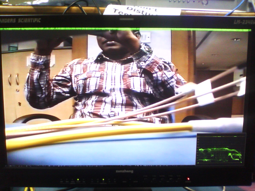

I am attaching the snapshots taken when the noise is present in the display ,
use case 1 : 576i capture and bypass through DEI and displayed on OnChipSD :
As we can see there is green noise at the top and bottom .

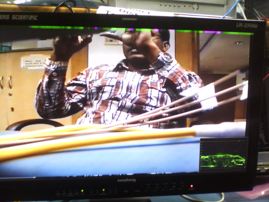

use case 2 : 576i capture ,deinterlaced and upscaled to 1080P using DEI and displayed on Onchip HDMI
We have got a camera which provides 576i (PAL) input to the VIN0 PORTA , i tried changing the input source and i can see the similar noise with that too .
I have also tried capturing 576i (PAL ) video data and storing into a file with OMX application , when i play the file on the host machine ,i don't see any noise in this case . I suspect that DEI component is causing some problem .
Has anyone noticed this noise when you are using DEI component in the above use cases . Can anyone suggest me what might be wrong ? Any help is appreciated .
