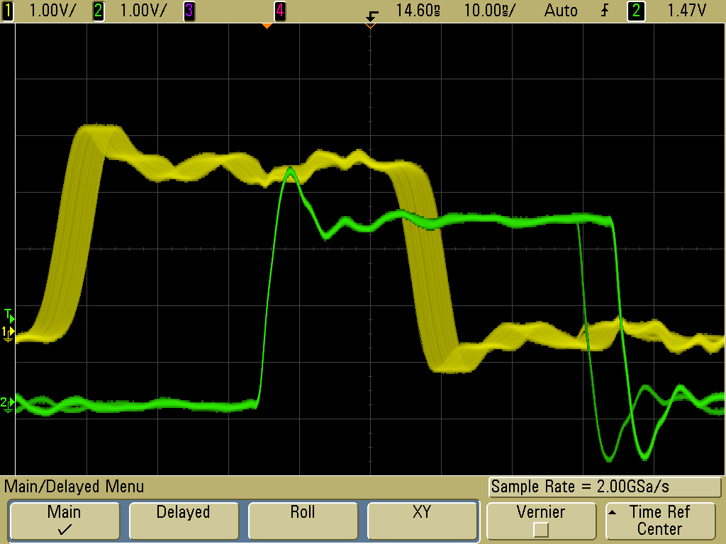

On R31.t13 a block signal of 10MHz is present. In this program I try to follow this input with output pin R30.t10
On a scope. I see this picture:
The yellow trace is the input signal on R31.t13, and the green trace is the output on R30.t10.
Since the input signal is asynchronous with respect to the PRU clock, 5 ns jitter is present.
What puzzles me is the delay of 25 ns between the input and the output.
From chapter 25.3.4.3 of the technical ref (Literature Number: SPRUH73G) I read that probably two clocks are lost before a change on a gpio pin is clocked in. This would account for 10 ns, so I still have 15 ns unexplained.

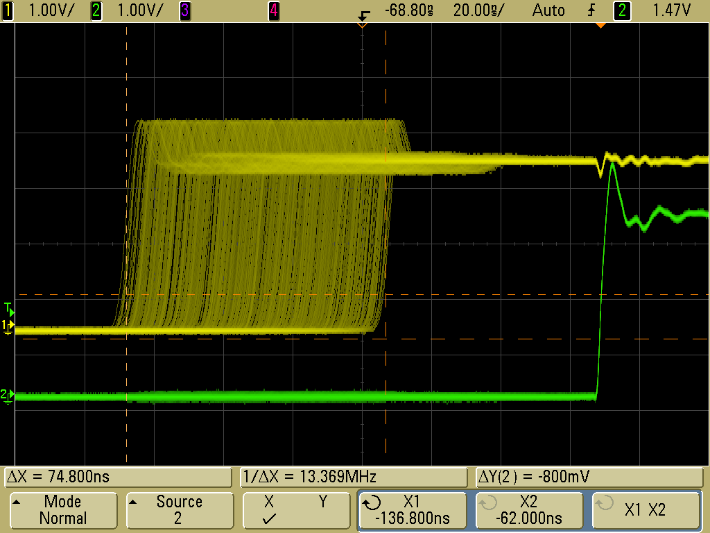

- 2) I have performed a similar test by polling the MSR of UART0 that is present in the PRUSS. Here the results are even more dramatic. It will last between 60 and 135 ns before the output follows the input. Partially this will be due to the extra instruction needed to read the register (LBCO R1, C7, 0x18, 1), but that does not explain the additional  35 ns with respect to the first test. Could it be that  the UART runs on another clock?
- 3) also, the jitter of the second test is 75 ns. Does that mean that the LBCO instruction can take up to 75 - 5 = 70 ns?
Below code and picture of 2nd test
L_MODE5_WAIT_0:
   lbco     r1, C7, 0x18, 1
   qbbs     L_MODE5_WAIT_0, r1, 4        // input = '1'? (note CTSn inverts)
   SET      R30.t10                      // set output high
L_MODE5_WAIT_1:
   qbbc     L_MODE5_WAIT_1, r1, 4        // input = '0'? (note CTSn inverts)
   clr      R30.t10                      // set output low
   JMP      L_MODE5_WAIT_0
Yellow: input on UART0_CTS (1 MHz block)
Green: the output on R30.t10.
    PRU cores are clocked at 200 MHz - so each instruction (if there are no external bus accesses) like operations performed on registers take 5ns. So in this case 3 instructions in between Output Low to Output High account for 15ns.
    You can see the instruction cycle count and stall count using CCS>PRU debug window> Registers > Debug.
    In CONTROL register - enable CountEnable. CycleCnt  and StallCnt registers respectively show the total cycle count and total stall count.
    From this I can confirm that LBCO to UART takes 14 cycles => 70ns and SBCO takes 2 cycles =>10ns
