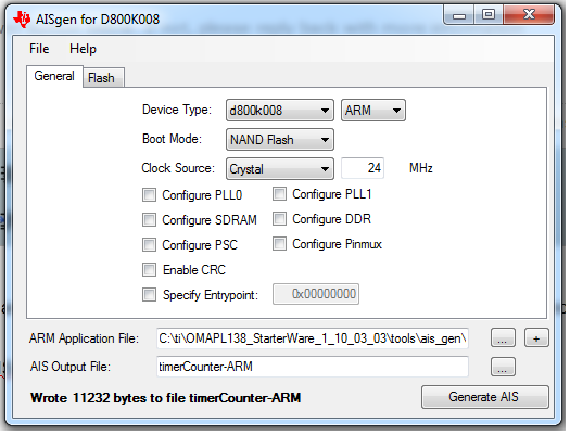

    Sachin and I have OMAPL138 LCDK which only has NAND and no SPI/NOR memory. This board doesn't have a serial port either and we have to use a USB-to-serial convertor (I have configured for COM2). We want to burn a ARM/DSP/ARM+DSP image to the NAND and boot from there. We are not using Linux/uBoot and are using Starterware examples.
    I tried converting a ARM .out file into AIS format using the AISgen utility, see snapshot below:
    (Flash data width is 8 bits by default which I have not changed)
    After this, I used the below command to flash the image on NAND:
    sfh_OMAP-L138.exe -flash_noubl -flashType NAND -p COM2 C:\ti\OMAPL138_StarterWare_1_10_03_03\tools\ais_gen\timerCounter-ARM

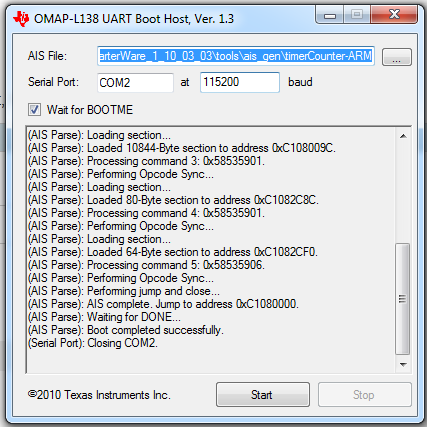

    It didn't go after this. I tried multiple times but same result. After that, I used the Uarthost utility:
    Output of this is:
    (File IO): Read 11232 bytes from file C:\ti\OMAPL138_StarterWare_1_10_03_03\tools\ais_gen\timerCounter-ARM.
    (Serial Port): Opening COM2 at 115200 baud...

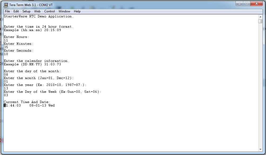

  • Sachin,
                I checked the booting part of C6748 LCDK from NAND boot as per the following wiki Link.
    http://processors.wiki.ti.com/index.php/LCDK_User_Guide#NAND_Flashing
    I tested the C6748 Starterware Timer example to do this.
    The steps which I followed are as follows.
    1.    I used the timer example from the C6748 starterware: C6748_StarterWare_1_20_03_03\build\c674x\cgt_ccs\c6748\lcdkC6748\timer.Debugged this example in CCS and obtained the timecounter.out file.
     2.    Then downloaded the LCDK AISGen config file from the wiki Link mentioned above. Loaded this config file to the AISGen utility and gave the timecounter.out as the inputfile to the utility and created the timecounter_C6748lcdk_ais.bin.
     3.     Changed the board switch settings to UART boot mode [0101] and using the serial flasher utility I flashed the images to the board.
                              Use C6748_StarterWare_1_20_03_03\tools\flash_writer
                                            sfh_OMAP-L138.exe -targetType C6748_LCDK -flashtype NAND -p COM3 –erase
                                             sfh_OMAP-L138.exe -targetType C6748_LCDK -flashtype NAND -p COM3 -flash_noubl timecounter_C6748lcdk_ais.bin
     4.      Change the switch settings to NAND bootmode[0111] and poweron the board.
     I am also attaching all the binaries and config files for your reference. You can follow the steps as per the LCDK user guide wiki page and check whether its working for you.
    Iyshwarya

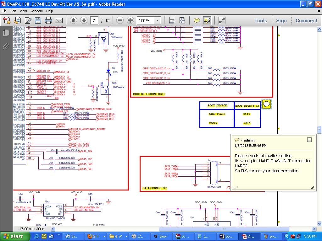

  • Sachin,
    You are not using the right switch settings, please correct that and try again.
  •  I saw the switch settings from your schmatics. Its correct for uart2 but wrong for NAND FLASH. So, Please correct this. Due to this my lots of time waste.
    regards
    Sachin Arora
  • Hi Sachin,
                 Kindly note that in the schematics of LCDK , the table represents the BIT value and you have mis interpreted it with the switch settings.
    The schematics doesn’t represent the switch settings and the switch settings is as per the LCDK user guide wiki link.
    Note:
    For further clarifications, Please refer the SPRAB41D OMAP-L132/L138 Boot loader Doc (sprab41d.pdf) for Boot mode Switch Settings on page no 29
    Iyshwarya
