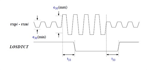

    1. In the PCIE_SERDES_STS register(SPRUGS6C p32):
    it's value is 0x309 after power reset.  which means the LOSDTCT1, LOSDTCT0,SYNC1 is 1.
    after our configuration, it will become 0x109(x2)or 0x101(x1),  this is very weird ,because  for the successful link up ,it will be 0x1.
    the LOSDTCT(lost of signal detect) and sync(Symbol alignment) should be 0.  I don't get much information about these fields and don't understand well, I hope you or someone can explain this.

  • Xing,
    1.Each receive lane supports loss of signal (also known as electrical idle) detection, configured via the RX_LOS bits of SERDES_CFG0/1 registers.
    When enabled, the differential signal amplitude of RXp and RXn is monitored. Depending on whether it is below or above the threshold levels, the LOSDTCT bit of PCIE_SERDES_STS register is asserted high or low respectively, as shown in the figure below. The threshold levels are described by e30 in the figure, which is normally min=75mVdfpp, max=125mVdfpp.
    When the differential signal amplitude crosses the threshold, LOSDTCT will change state asynchronously within 50ns (t33).
    When LOSDTCT is asserted high, clock recovery will stop, and the state is retained.

    I think the lost of signal may be due to some hardware issue on your board that the receive signal could not meet the threshold requirement. And when LOSDTCT is 1, the clock recovery is stopped, which may affect the link up.
    So I am wondering if you could improve the signal integrity on your board. Or you could try to disable the lost signal detection by setting RX_LOS=0 in both SERDES_CFG0 and SERDES_CFG1 registers to see if the link up could be done successfully.
