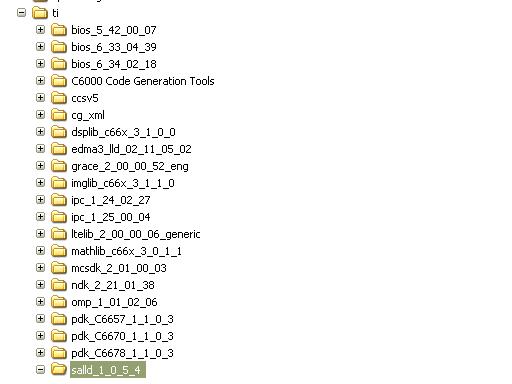

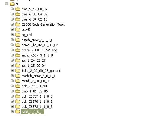

    Thanks for the information provided. We could successfully download the SA LLD package for windows environment but unable to create SA projects. Please find below the list of  installation steps followed
    • Installed the package in C:/ti/salld_1_0_5_4/  folder
    • After successful installation, the directory structure is formed as below
    • Modified the PDK_INSTALL_PATH in sasetupenv.bat file and executed the batch file
    • Executed sabuild.bat and sabuildall.bat files

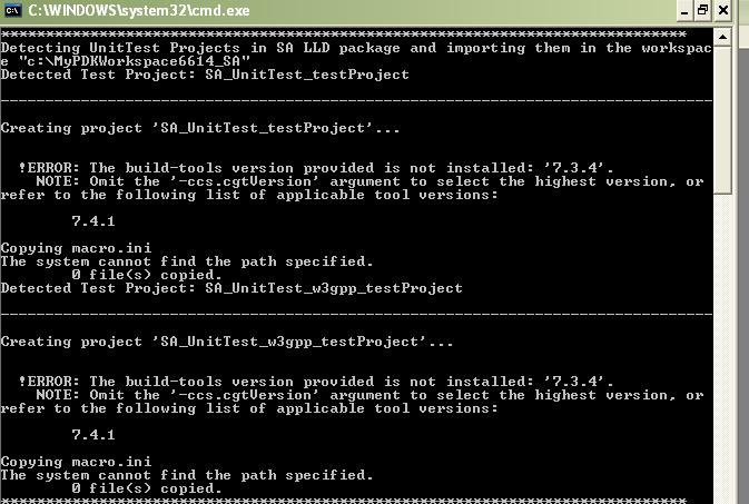

    • For creating CCS project for SA package, modified the “IS_SIMULATOR_SUPPORT_NEEDED” variable from no to yes and executed the batch file.
    • After execution of batch file, workspace is created but no projects are found. Please find the below snapshot for the same
    Any points/steps missed during this procedure?  If yes could you please let us know the sequence of steps to be followed?

  • Hi, Usha:
    There is no need to rebuild the libraries unless you really want to.
    You need to follow the error messages to update the batch file until the project is created. For example, change "set CGT_VERSION=7.3.4" to "set CGT_VERSION=7.4.1"
    Please note that the simulator does not perform actual encryption and authentication. You will need C6670/C6678X EVM. Besides, the C6670/C6678 simulator may be too old to work as indicated at the SA release notes.
