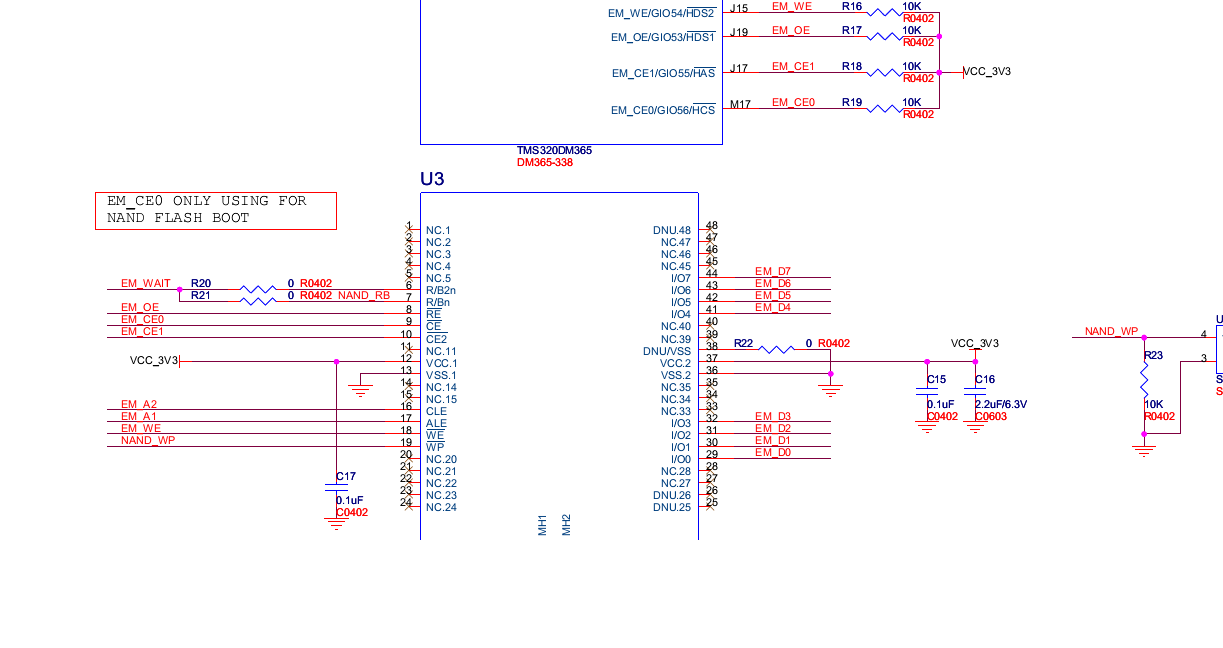

  • Hi ?
    We used our customer Board.
    Micron NAND(256MiB) is good, but Samsung NAND(128MiB) is failed.
    We used SDK normal dm3xx_sd_boot and u-boot (leopardboard dm365).
    log attached...

  • The attached sch could work with K9F1G08U0C,MT29F2G08AADWP,i think it also could work for  K9F1G08U0M,hope it could help.
