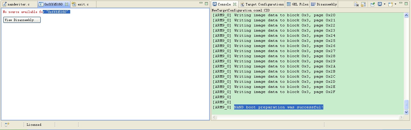

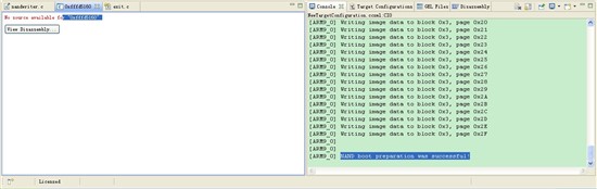

  • Hi, thank you for you help.   The method is  really effective, I have finished  uboot  flashed. But the board still coundn't come up. when nandwriter has be executed , the state is showed as below. can you tell me whether the uboot is reflashed  right.   Why the board didn't come up?  What I can do next ?  Thank you.  Good wishes for you !
