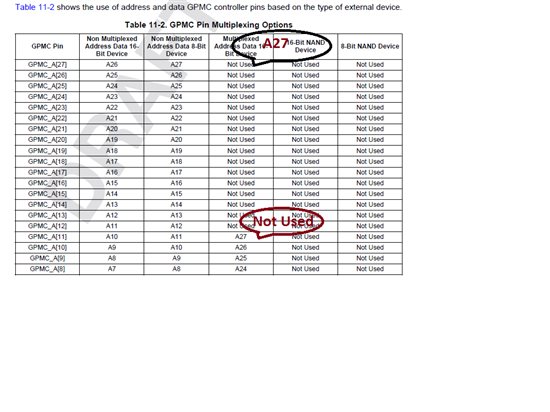

We are using DM814x processor and FPGA in our custom board. A 2Gb DDR3 is  connected to FPGA. We should interface with DDR3 using GPMC connected to FPGA. I've written FPGA driver for I2C and SPI communication between processor and FPGA (for FPGA control register access only) and also to access that FPGA DDR3 using GPMC.  Here is the piece of code that I've written.

When I execute the above driver code,
physical addr returned by gpmc_cs_request (fpga_i2c_di->control_mem_base) = 0x10000000
virtual addr returned by ioremap_nocache function(fpga_i2c_di->ctl_addr) = 0xdc000000
We are using address and data multiplexed interfacing of NOR protocol. So, 27 lines are connected to DDR3 to access 256MB (each memory location is of 2 bytes). The problem is, while making read and write transactions using the virtual address returned from ioremap, physical address received on bus 0x4000000.  But I expect the address 0x0000000  on the bus. What is the mistake in this code?? how is this possible?? Can anyone please help in this issue??
Also we use only two chip selects in our board. NAND uses only 16MB which is not colliding with this ddr3 address.

    Which implies that, the controller has given me access for 256MB. i.e 0x1000_0000 is a 32 bit address. To access 256MB (address location of 2 bytes), 27 lines are connected in our hardware.  So, from the 32 bit start address (0x1000_0000) received,  I should get the lower 27 bits in the address bus which is 000_0000 while performing transactions. But I am getting, 400_0000 in the bus. How is this possible?? I am checking this by writing from driver code(kernel space)  to the ioremapped location.
    For 27 lines, if
    start address : 0x000_0000
    end address :  0x7FF_FFFF,  we can access 256MB. That is how we calculated.
    But In the current scenario, we receive the  start_address : 0x400_0000, which restricts our access to 128MB.
    vaishnavi

  • Hi Viet,
    We read the actual address in the gpmc bus using xilinx FPGA utility chipscope. For multiplexed address data 16-bit device, we should use A1-A11 as address bus and D0-D16 as bidirectional bus. So, totally we use 27 address lines to access 256MB (each location of 2 bytes).
    When I add an offset (eg. 0x1, 0x2 etc..) to the ioremapped address and perform transaction, I receive the address without any shift. ie..
    sent address from driver                                      received address on bus
    ioremapped address + 0x1                                      0x400_0001
    ioremapped address + 0x2                                      0x400_0002 etc..
    So, we are not sure about shift in address.
    One more information is, When we do the same GPMC configuration from CCS and then a write/read transaction,  I am able to get the expected start address 000_0000 in the gpmc bus. So, from CCS, we are able to prove the interface. Only from linux, we are facing the above issues.
    Vaishnavi

    ie. Address line A11 is always high. But that is not the actual case. Since we are using FPGA, every IO pin will have a pin property (PULLUP or PULLDOWN etc). So, it is the pin property of FPGA which has reflected on that line. What is happening is, I am unable to drive that A11  address line.  The other address lines are becoming low, because I'm able to drive those lines. Since, I am unable to drive A11, the default pin property has reflected.
    I've already given my gpmc config register values and also the code. Is there any mistake in that?? Why am I not able to drive A11?? Any help would be greatly appreciated.

  • Hi Vaishnavi,
    Do you happen to use old TRM?  The latest TRM is SPRUGZ8C.  There is a bug in old TRM and the address for GPMC Multiplexed mode column has been update in Table 11-2.  Could you double check and confirm?

  • Hi Vaishnavi,
    Could you let us know the physical pin ID that GPMC_A[11] that you connect to?  Have you double check with our pinmux utility on our TI 8148 product folder to make sure there is no conflict in your setup?
    BR,
    Viet
  • Hi Viet,
    GPMC_A[11] is connected to the physical pin ID  AB23.  Also, We've verified that there is no conflict in our setup. I've a doubt.  What do the Table 11-52 in TRM (sprugz8c)  refer to?? How it is different from Table 11-2 in the same TRM?? please comment.
  • Hi Vaishnavi,
    I think you found a bug in our TRM.  Can you try the A27 to GPMC_A[27] to see if it works for you?  We confirm it is in our other device.  We are very sorry for this mistake and we will fix it in our next TRM release.  About the Table 11-52, it should look like Table 11-2 instead.  We will also fix it in next release.
    BR,
    Viet
  • Hi Viet,
    Feeling glad to say that IT'S WORKING!!!!!!!!!! If we connect A27 to GPMC_A[27] , it's working exactly fine as expected.
    Thank you for your effort and help in solving this issue.
    Vaishnavi
  • Hi Vaishnavi,
    Thank you very much for your confirmation.  We are very sorry for this inconvenience and we will fix the TRM in next release.
