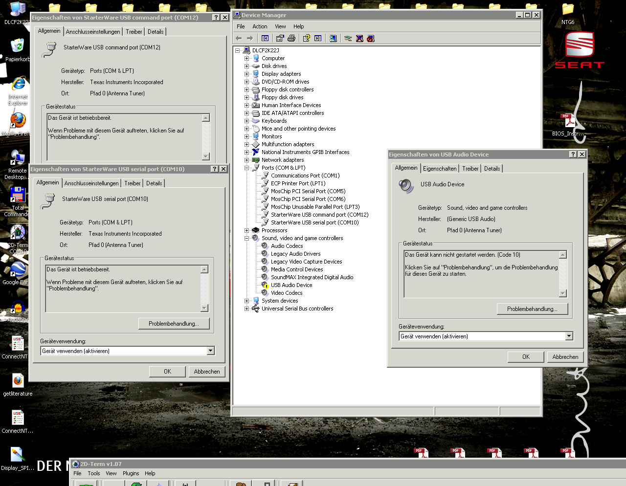

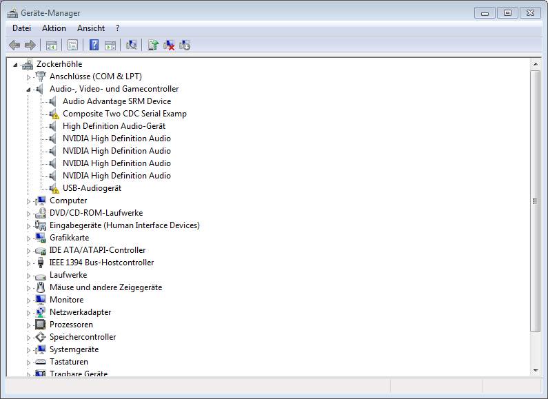

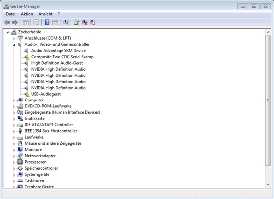

    after quite some work, I have tested the enumeration of the TwoCDC Serial example (using the available .inf file) and seperately the Standard USB Audio Device - both as solo projects. Both USB Devices work well. In an additional step, I have combined all three functions in a single composite device with the help of the starterware usb user manual. In that device, the serial functions work, but still Windows reports the USB Audio Device as not operateable (Could not be started ERROR 10) - see attached device manager picture. My questions are:
    1.) Is it possible to enumerate a combination of custom and standard interface functions in one device?
    2.) How do I debug this error in my software stack ?
