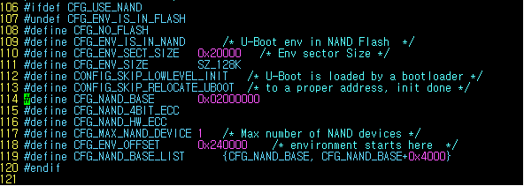

  •  Hi,
    You can find config header file named davinci_dm365_ipnc.h in directory "u-boot/include/configs"
    You check  options relate with hw ecc  is turned on. If it is on, you check ecc layout in "u-boot/cpu/arm926ejs/davince/nand.c.
    In the Kernel, ecc layout would be found in linux//drivers/mtd/nand/davinci_nand.c.
    BR,
    Choi

  • Hi
    I have check and change AWCCR, A1CR to maximum values in u-boot source, I did not change UBL because of i have not source about UBL source.
    Anyway Test result same...
    * u-boot >> cpu/arm926ejs/davinci/nand.c
