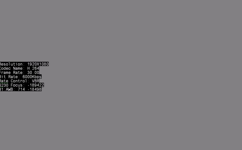

  • Hi ,Viet,
    I am working in DM8148 board. The board was designed base on  APPRO 8127IPNC . We are using the IPNC V3.2 software. we replace camera sensor(9j003) by YUV 16bit 1080P input. but the image is gray.We change part of ISS,as below:
    1.       \psp\iss\drivers\capture\src\issdrv_captureApi.c
    2.       \psp\iss\core\src\iss_drv_isif.c
    3.       \psp\iss\core\src\iss_drv_ipipe.c
    I think there are some mistakes in our configurations.please give me some good advices to solve the problem ,thank you!
    jiger
  • Hi ,Viet ,
    The image is gray ,as below:
    Jiger
