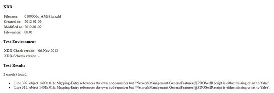

I'm testing powerlink slave with ICE board
But I can't run powerlink live CD because of LanCard (That application needs specific Lancard)
so I have to use openPowerlink source via Ubuntu and that application need XAP.H file
This header file is generated from Powerlink XDD file But When I Validate This xdd file via "ethernet-powerlink.org", there are two errros
(XDD file is from SDK (1.0.0.5) Example folder )
here is result of validation
so I can't get normal XAP.H only PI_IN structure in Header
plz, let me know What to do..
