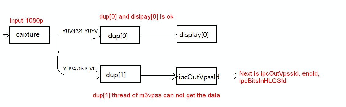

Hi all,
    I test DM8168EMV+DaughterCard based on DVRRDK3.0. The demo run ok for 1080p preview. But now it does not encode. I track the code and find DupLink_tskMain() of m3vpss's DUP1 thread can not get data. But DupLink_tskMain() of DUP0 continues getting SYSTWM_CMD_NEW_DATA. So the preview is ok.
    I think the root cause is capture's link configuration. Below is capture's configuration
    capturePrm.outQueParams[0].nextLink = gMultiChHd_VcapVencVdisObj.dupId[0];
    capturePrm.outQueParams[1].nextLink = gMultiChHd_VcapVencVdisObj.dupId[1];
    pCaptureOutPrm                      = &pCaptureInstPrm->outParams[0];
    pCaptureOutPrm                      = &pCaptureInstPrm->outParams[1];
    Below is debugging flow.
    Print every thread's id, link id,... of DupLink_getFullFrames(), DupLink_putEmptyFrames(), DupLink_tskMain(),CaptureLink_tskRun(), CaptureLink_drvProcessData(), ...
    Could anyone help me?
  • How are you getting one capture output in YUV 420SP and another capture output in YUV 422I . Pls share your usecase c file so that the configuration and connection can be reviewed
    Capture link supports 4 output queues, by default it stores all outputs to queid 0, i think you need to use 2 queues, one for dup0 and other for dup1. You can configure capture parameters to use specific queue by configuring outQueId parameter in outParams capture output parameters. Please also configure dup1 to use queue 1 of the capture link.

  • Here is the multichhd_vcap_venc_vdis.c code. Thanks!

        CaptureLink_CreateParams_Init(&capturePrm);
        dpline();
        capturePrm.numVipInst               = 1; /* Need to change based on actual HD video decoder */
        capturePrm.tilerEnable              = FALSE;
        capturePrm.fakeHdMode               = TRUE;
        capturePrm.enableSdCrop             = FALSE;
        capturePrm.doCropInCapture          = FALSE;
        capturePrm.maxBlindAreasPerCh       = 4;
        for(vipInstId=0; vipInstId<capturePrm.numVipInst; vipInstId++)
            pCaptureInstPrm                     = &capturePrm.vipInst[vipInstId];
            pCaptureInstPrm->vipInstId          = (SYSTEM_CAPTURE_INST_VIP0_PORTA+vipInstId)%SYSTEM_CAPTURE_INST_MAX; /* Need to change based on actual HD video decoder */
            pCaptureInstPrm->videoDecoderId     = SYSTEM_DEVICE_VID_DEC_TVP7002_DRV; /* Need to change based on actual HD video decoder */
            pCaptureInstPrm->inDataFormat       = SYSTEM_DF_YUV422P;
            pCaptureInstPrm->standard           = SYSTEM_STD_1080P_60; /* Need to change based on actual HD video decoder */
            pCaptureInstPrm->numOutput          = 1; /* Need to change based on actual HD video decoder */
            pCaptureOutPrm->dataFormat          = SYSTEM_DF_YUV422I_YUYV;//SYSTEM_DF_YUV420SP_UV;
            pCaptureOutPrm->scEnable            = FALSE; /* Need to change based on actual HD video decoder */
            pCaptureOutPrm->scOutWidth          = 0; /* Need to change based on actual HD video decoder */
            pCaptureOutPrm->scOutHeight         = 0; /* Need to change based on actual HD video decoder */
            pCaptureOutPrm->outQueId            = 0;
    #if 1
        /* Second stream */
            pCaptureOutPrm->dataFormat          = SYSTEM_DF_YUV420SP_VU;//SYSTEM_DF_YUV420SP_UV;
            pCaptureOutPrm->scOutWidth          = 1920; /* Need to change based on actual HD video decoder */
            pCaptureOutPrm->scOutHeight         = 1080; /* Need to change based on actual HD video decoder */
            pCaptureOutPrm->outQueId            = 1;
    #endif
            if (vipInstId >= numSubChains)
            else
        for(i = 0; i < NUM_CAPTURE_DEVICES; i++)
            vidDecVideoModeArgs[i].videoIfMode        = DEVICE_CAPT_VIDEO_IF_MODE_16BIT;
            vidDecVideoModeArgs[i].videoDataFormat    = SYSTEM_DF_YUV422P;
            vidDecVideoModeArgs[i].standard           = SYSTEM_STD_1080P_60;
            vidDecVideoModeArgs[i].videoCaptureMode   =
                        DEVICE_CAPT_VIDEO_CAPTURE_MODE_SINGLE_CH_NON_MUX_EMBEDDED_SYNC;
            vidDecVideoModeArgs[i].videoSystem        =
                                          DEVICE_VIDEO_DECODER_VIDEO_SYSTEM_AUTO_DETECT;
            vidDecVideoModeArgs[i].videoCropEnable    = FALSE;
            vidDecVideoModeArgs[i].videoAutoDetectTimeout = -1;
        dpline();
        Vcap_configVideoDecoder(vidDecVideoModeArgs, NUM_CAPTURE_DEVICES);
        dpline();
        dupPrm[0].inQueParams.prevLinkId        = gVcapModuleContext.captureId;
        dupPrm[0].inQueParams.prevLinkQueId     = 0;
        dupPrm[0].numOutQue                     = 1;
    #ifdef ENABLE_ENCODE_201212
        //dupPrm[0].outQueParams[0].nextLink      = gVcapModuleContext.deiId[0];
        dupPrm[0].outQueParams[0].nextLink      = SYSTEM_LINK_ID_DISPLAY_0;
    #endif
        dupPrm[0].notifyNextLink                = TRUE;
        dupPrm[1].inQueParams.prevLinkId        = gVcapModuleContext.captureId;
        dupPrm[1].inQueParams.prevLinkQueId     = 1;
        dupPrm[1].numOutQue                     = 1;
        //dupPrm[1].outQueParams[0].nextLink      = gVcapModuleContext.deiId[1];
        dupPrm[1].outQueParams[0].nextLink      = gMultiChHd_VcapVencVdisObj.ipcOutVpssId;
        dupPrm[1].notifyNextLink                = TRUE;
        dpline();
    #if 0
            i = 0;
            Int32 chId;
            DeiLink_CreateParams_Init(&deiPrm[i]);
            deiPrm[i].inQueParams.prevLinkId                           = gMultiChHd_VcapVencVdisObj.dupId[i];
            deiPrm[i].inQueParams.prevLinkQueId                        = 0;
            /* Set non default DEI Frame Rate */
            deiPrm[i].inputFrameRate[DEI_LINK_OUT_QUE_DEI_SC]       = 30;
            deiPrm[i].outputFrameRate[DEI_LINK_OUT_QUE_DEI_SC]      = 30;
            deiPrm[i].inputFrameRate[DEI_LINK_OUT_QUE_VIP_SC]       = 30;
            deiPrm[i].outputFrameRate[DEI_LINK_OUT_QUE_VIP_SC]      = 30;
            deiPrm[i].comprEnable                                   = FALSE;
            deiPrm[i].setVipScYuv422Format                          = FALSE;
            deiPrm[i].enableDeiForceBypass                          = TRUE;
            deiPrm[i].enableLineSkipSc                              = FALSE;
            deiPrm[i].outQueParams[DEI_LINK_OUT_QUE_DEI_SC].nextLink= SYSTEM_LINK_ID_DISPLAY_0;
            i = 1;
            Int32 chId;
            deiPrm[i].outQueParams[DEI_LINK_OUT_QUE_DEI_SC].nextLink= gMultiChHd_VcapVencVdisObj.ipcOutVpssId;
    #endif
        //displayPrm[0].inQueParams[0].prevLinkId        = gVcapModuleContext.deiId[0];
        displayPrm[0].inQueParams[0].prevLinkId        = gMultiChHd_VcapVencVdisObj.dupId[0];
    #endif
        displayPrm[0].inQueParams[0].prevLinkQueId     = 0;
        displayPrm[0].displayRes                    = gVdisModuleContext.vdisConfig.deviceParams[VDIS_DEV_HDMI].resolution;//displayRes[SYSTEM_DC_VENC_HDMI];
        ipcOutVpssPrm.inQueParams.prevLinkId    = gMultiChHd_VcapVencVdisObj.dupId[1];
        ipcOutVpssPrm.inQueParams.prevLinkQueId = 0;
        ipcOutVpssPrm.outQueParams[0].nextLink  = gMultiChHd_VcapVencVdisObj.ipcInVideoId;
        ipcOutVpssPrm.notifyNextLink            = TRUE;//FALSE;
        ipcOutVpssPrm.notifyPrevLink            = TRUE;
        ipcOutVpssPrm.noNotifyMode              = FALSE;
        ipcInVideoPrm.inQueParams.prevLinkId    = gMultiChHd_VcapVencVdisObj.ipcOutVpssId;
        ipcInVideoPrm.inQueParams.prevLinkQueId = 0;
        ipcInVideoPrm.outQueParams[0].nextLink  = gVencModuleContext.encId;
        ipcInVideoPrm.notifyNextLink            = TRUE;
        ipcInVideoPrm.notifyPrevLink            = FALSE;
        ipcInVideoPrm.noNotifyMode              = TRUE;
        ipcBitsOutVideoPrm.baseCreateParams.inQueParams.prevLinkId    = gVencModuleContext.encId;
        ipcBitsOutVideoPrm.baseCreateParams.inQueParams.prevLinkQueId = 0;
        ipcBitsOutVideoPrm.baseCreateParams.outQueParams[0].nextLink   = gVencModuleContext.ipcBitsInHLOSId;
        MultiCh_ipcBitsInitCreateParams_BitsOutRTOS(&ipcBitsOutVideoPrm, TRUE);
        ipcBitsInHostPrm[0].baseCreateParams.inQueParams.prevLinkId    = gVencModuleContext.ipcBitsOutRTOSId;
        ipcBitsInHostPrm[0].baseCreateParams.inQueParams.prevLinkQueId = 0;
        ipcBitsInHostPrm[0].baseCreateParams.outQueParams[0].nextLink   = SYSTEM_LINK_ID_INVALID;
        MultiCh_ipcBitsInitCreateParams_BitsInHLOS(&ipcBitsInHostPrm[0]);
        encPrm.numBufPerCh[0] = 6; //D1
        encPrm.numBufPerCh[1] = 4; //CIF
            EncLink_ChCreateParams *pLinkChPrm;
            EncLink_ChDynamicParams *pLinkDynPrm;
            VENC_CHN_DYNAMIC_PARAM_S *pDynPrm;
            VENC_CHN_PARAMS_S *pChPrm;
            /* Primary Stream Params - D1 */
            for (i=0; i<gVencModuleContext.vencConfig.numPrimaryChn; i++)
                pLinkChPrm  = &encPrm.chCreateParams[i];
                pLinkDynPrm = &pLinkChPrm->defaultDynamicParams;
                pChPrm      = &gVencModuleContext.vencConfig.encChannelParams[i];
                pDynPrm     = &pChPrm->dynamicParam;
                pLinkChPrm->format                  = IVIDEO_H264HP;
                pLinkChPrm->profile                 = gVencModuleContext.vencConfig.h264Profile[i];
                pLinkChPrm->dataLayout              = IVIDEO_FIELD_SEPARATED;
                pLinkChPrm->fieldMergeEncodeEnable  = FALSE;
                pLinkChPrm->enableAnalyticinfo      = pChPrm->enableAnalyticinfo;
                pLinkChPrm->enableWaterMarking      = pChPrm->enableWaterMarking;
                pLinkChPrm->maxBitRate              = pChPrm->maxBitRate;
                pLinkChPrm->encodingPreset          = pChPrm->encodingPreset;
                pLinkChPrm->rateControlPreset       = pChPrm->rcType;
                pLinkChPrm->enableSVCExtensionFlag  = pChPrm->enableSVCExtensionFlag;
                pLinkChPrm->numTemporalLayer        = pChPrm->numTemporalLayer;
                pLinkDynPrm->intraFrameInterval     = pDynPrm->intraFrameInterval;
                pLinkDynPrm->targetBitRate          = pDynPrm->targetBitRate;
                pLinkDynPrm->interFrameInterval     = 1;
                pLinkDynPrm->mvAccuracy             = IVIDENC2_MOTIONVECTOR_QUARTERPEL;
                pLinkDynPrm->inputFrameRate         = pDynPrm->inputFrameRate;
                pLinkDynPrm->rcAlg                  = pDynPrm->rcAlg;
                pLinkDynPrm->qpMin                  = pDynPrm->qpMin;
                pLinkDynPrm->qpMax                  = pDynPrm->qpMax;
                pLinkDynPrm->qpInit                 = pDynPrm->qpInit;
                pLinkDynPrm->vbrDuration            = pDynPrm->vbrDuration;
                pLinkDynPrm->vbrSensitivity         = pDynPrm->vbrSensitivity;
            encPrm.inQueParams.prevLinkId   = gMultiChHd_VcapVencVdisObj.ipcInVideoId;
            encPrm.inQueParams.prevLinkQueId= 0;
            encPrm.outQueParams.nextLink    = gVencModuleContext.ipcBitsOutRTOSId;
        capturePrm.isPalMode = Vcap_isPalMode();
        dpline();
        System_linkCreate (gVcapModuleContext.captureId, &capturePrm, sizeof(capturePrm));
        dpline();
        for(i=0;i<2;i++) {
           System_linkCreate(gMultiChHd_VcapVencVdisObj.dupId[i], &dupPrm[i], sizeof(dupPrm[i]));
           dpline();
        dpline();
    #if 0
        for(i=0;i<2;i++) {
            System_linkCreate(gVcapModuleContext.deiId[i], &deiPrm[i], sizeof(deiPrm[i]));
           dpline();
    #endif
        System_linkCreate(gMultiChHd_VcapVencVdisObj.ipcOutVpssId , &ipcOutVpssPrm , sizeof(ipcOutVpssPrm) );
        dpline();
        System_linkCreate(gMultiChHd_VcapVencVdisObj.ipcInVideoId , &ipcInVideoPrm , sizeof(ipcInVideoPrm) );
        dpline();
        System_linkCreate(gVencModuleContext.encId, &encPrm, sizeof(encPrm));
        dpline();
    #if 1
        System_linkCreate(gVencModuleContext.ipcBitsOutRTOSId, &ipcBitsOutVideoPrm, sizeof(ipcBitsOutVideoPrm));
        dpline();
        System_linkCreate(gVencModuleContext.ipcBitsInHLOSId, &ipcBitsInHostPrm[0], sizeof(ipcBitsInHostPrm[0]));
        dpline();
        //System_linkGetInfo(gVcapModuleContext.ipcFramesInHostId,&framesProducerLinkInfo);
        //dpline();
    #endif
        System_linkCreate(gVdisModuleContext.displayId[0], &displayPrm[0], sizeof(displayPrm[0]));
        dpline();
        MultiCh_memPrintHeapStatus();
        dpline();
    Void MultiChHd_deleteVcapVencVdis()
    Capture number of outputs is set to 1, in this case, it will not at all capture YUV420 data. it should be set to 2.
    Brijesh Jadav
  • That's great. I will try it again! Thanks for your reply
