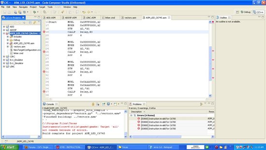

    ya i studied about the CALLP instruction ( in CPU and Instruction set guide, it wont have example for CALLP Instruction) and i used . but it showing some error . how i over come this .? please help. i attached the program which i used CALLP instruction and i attached the error message also.
    Program: 8357.ASM_LED_C6745.asm
    Vector : 2867.vectors.asm
    Error Message:
    Error in console window:
    'Building file: ../ASM_LED_C6745.asm'
    'Invoking: Compiler'
    "C:/Program Files/Texas Instruments/ccsv4/tools/compiler/c6000/bin/cl6x" -mv6700 -g --include_path="C:/Program Files/Texas Instruments/ccsv4/tools/compiler/c6000/include" --diag_warning=225 --preproc_with_compile --preproc_dependency="ASM_LED_C6745.pp"  "../ASM_LED_C6745.asm"
    "../ASM_LED_C6745.asm", ERROR!   at line 19: [E0800] Instruction invalid for
                                                         C6700
    				CALLP	Delay,B3
    "../ASM_LED_C6745.asm", ERROR!   at line 25: [E0800] Instruction invalid for
                                                         C6700
    				CALLP	Delay,A3
    "../ASM_LED_C6745.asm", ERROR!   at line 31: [E0800] Instruction invalid for
                                                         C6700
    				CALLP	Delay,A3
    "../ASM_LED_C6745.asm", ERROR!   at line 37: [E0800] Instruction invalid for
                                                         C6700
    				CALLP	Delay,A3
    4 Assembly Errors, No Assembly Warnings
    Errors in Source - Assembler Aborted
    >> Compilation failure
    C:\Program Files\Texas Instruments\ccsv4\utils\gmake\gmake: *** [ASM_LED_C6745.obj] Error 1
    'Building file: ../vectors.asm'
    "C:/Program Files/Texas Instruments/ccsv4/tools/compiler/c6000/bin/cl6x" -mv6700 -g --include_path="C:/Program Files/Texas Instruments/ccsv4/tools/compiler/c6000/include" --diag_warning=225 --preproc_with_compile --preproc_dependency="vectors.pp"  "../vectors.asm"
    'Finished building: ../vectors.asm'
    C:\Program Files\Texas Instruments\ccsv4\utils\gmake\gmake: Target `all' not remade because of errors.
    Build complete for project ASM_LED_C6745
    CCS Error :
    Thiyagarajan.S
  • Clue 4: CALLP is a C64+/C67+ instruction - see -mv option in compiler
  • Hi Jakez,
              yes you was correct. i changed as 6400+ then it took CALLP Instruction. again the same problem. Kindly go through my assembly code and tell why it is not returning from delay program. i done single stepping properly it reaching but once it entered . it not returning to main function.
