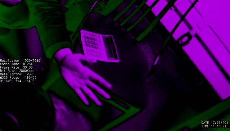

    We have solved  last problem,but we have a new problem in video color .It looks like Y/C components are swapped.The image attached as below.Pls give me some good advice .
    thanks.
    Jiger

  • Dear Rajat,
    We are using Camera Interface(I/F)  receiving the video data( 16bit, BT.1120.Embedded sync mode,YUV422 format) on DM8148.The hardware is base on APPRO's DM8127 IPNC and the software is IPNC RDK3.2. We connect the sensor with DM8148 board. this sensor output BT.1120/1080P(YUV422 format).We configure some ISS registers,and DM8148 board can accept the video data( 16bit,YUV422 format),but the color of the image is not right. We can confirm the senor works well.
    DM8148 board with the sensor  is the same as the HD IP camera.
    We think both U and V are reversal. how to swap U/V in ISS driver?
    Jiger
  • Jiger,
    You cannot swap the U/V in ISS output because what you are seeing is the fixed format in which ISS RSZ outputs YUV-422.
    But this is typically not a problem because when you use YUV-422 output in any other subsystem in the SOC for example HDVPSS, the ISS output format is also supported. Also, you can switch to YUV420 output format from the RSZ incase you want to use this output diretly for encoding.
    If you can tell me what do you want to do with the YUV 422 output frame I can suggest the datapath.
    Rajat

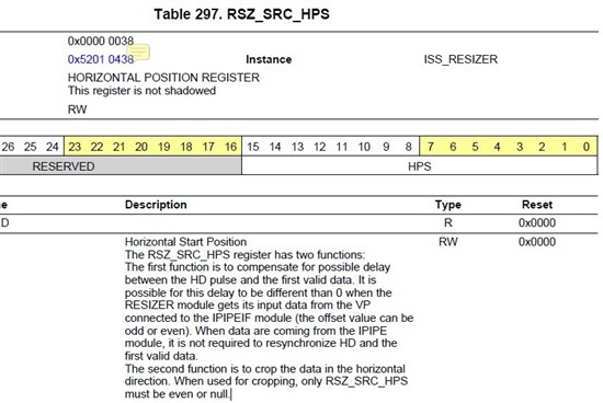

  • Also, I wanted to add that ISS RSZ supports in-line conversion from YUV422 to YUV420.
    Rajat
  • Jiger
    your want to change from
     UY VY UV VY
    to
    VY UY VY UY
    right?
    Why not just increase RSZ_SRC_HPS+1?
    Christian.

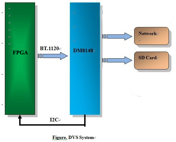

  • Dear Rajat,
    We are developing a HD IP-Video server,with HD-SDI input ,network output. there is a FPGA as HD-SDI input receiver,the FPGA output BT.1120 16bit data.Please give me some advices on this issue,how to conversion from YUV422 to YUV420?You great help is appreciated.
    Best regards
    Jiger
  • Dear Christian and Rajat,
    Thank you very much ,our product is HD-SDI Viedo Server.The schematic of  HD-SDI Video Server as below:
    Best Regards

  • Dear Christian:

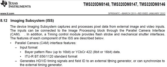

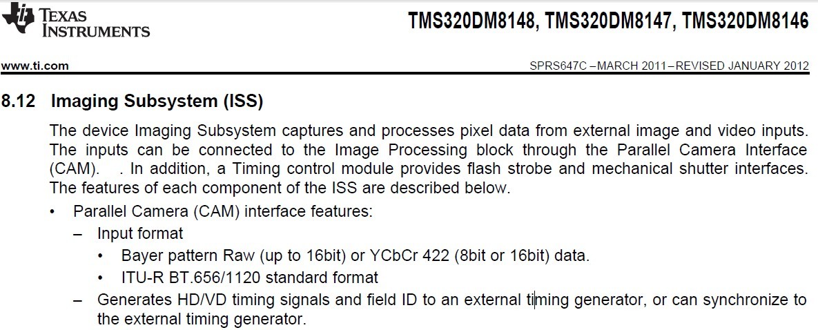

        the iss datasheet says:
    and you said:Why not just increase RSZ_SRC_HPS+1?
    in my case. which value is more appropriate for  RSZ_SRC_HPS .

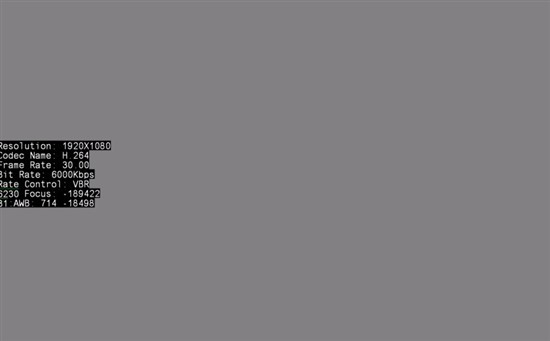

    when i config the pCameraOutPrm->dataFormat = SYSTEM_DF_YUV420SP_VU in first stream ignore the second stream.there no stream data to ouput.

    when i config the pCameraOutPrm->dataFormat = SYSTEM_DF_YUV422I_VYUY in first stream ignore the second stream.there will be stream data ouput,i can play it by VLC.but the corlor is incorrect.
    like this:
    Now.I don't know what 's the reason cause the color incrrect.can you give me some suggestions.

  • oddy,
    the idea is if RSZ read the next pixel , the UY VY read sequence will be inversted.
    so what is the current RSZ_SRC_HPS value which you're using,
    and what the image will be like if you increase the value by 1 and give it to RSZ_SRC_HPS?
    Christian.
