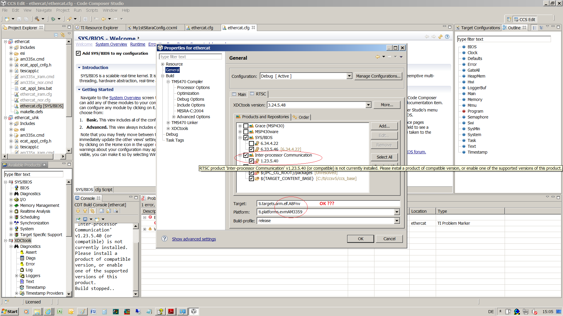

AM335x ICE EtherCAT slave example code buildung in CCSv5
after importing EtherCAT slave example (copy/not copy to workspace & check box/not checked "Automatically import referenced projects") i got an error message:
com.ti.rtsc.IPC missing
After double-click to ethercat.cfg cames a SYS/BIOS screen and i found that is related to XDCTools. Running the setup for XDCTools(3.24.05.48)/Bios(6.34.04.22)/AM335xSYSBIOS(1.0.0.6)/AM335xStarterWare(2.0.0.7) again.
Then i tried to change the general properties XDCTools (3.23.0.26 as it was created).
I tried to change project property compiler version 4.9.0[ARM] to 5.0.3.
Still the build aborting.
Attached the build results.

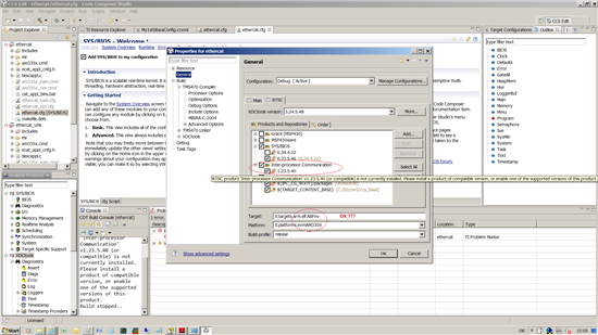

  • Hi Ulrich,
    Please uncheck IP package and try again, This package is not used in EtherCAT application.
    Shahid
  • Hi Shahid,
    thank You for the reply. I have unchecked the two boxes for IPC and $(IPC_CG_ROOT)/packages.
    Now there is in the "problems"-window no error/warning reported. But in the CDT_build_console was written could not make because of errors (unknown for me which and where to search now). The build log file:
