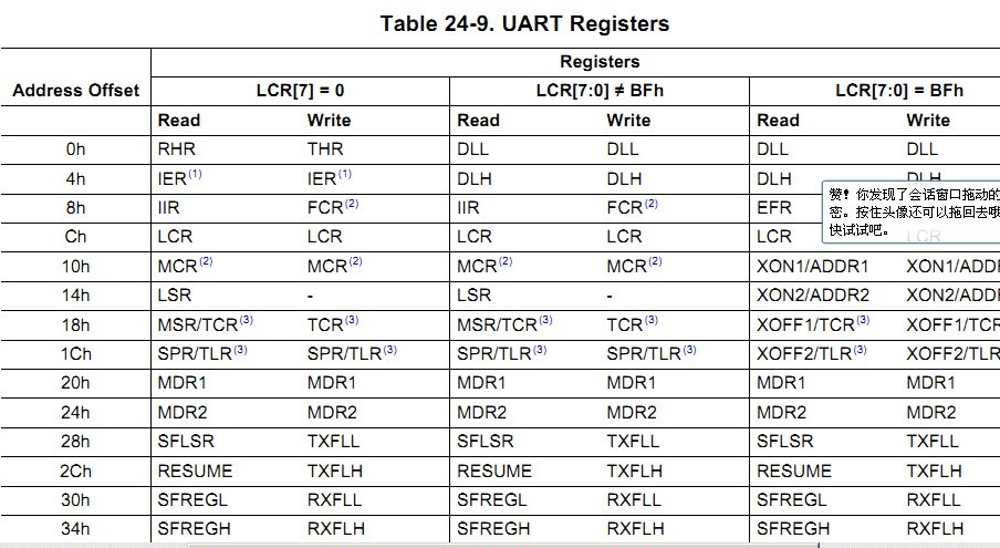

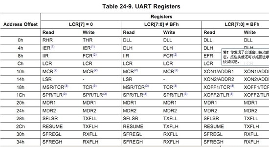

when I check the register of uart, I find that LCR[7] = 0,LCR[7:0]≠BFh and LCR[7:0] .my question is that if LCR[7:0]=13h, which group register can i choose, LCR[7]=0 or LCR[7:0]≠BFh? The regiter as shown in the following figure
Hi,all!
Since 13h is not equal to 0 nor to BFh, your case should be LCR[7:0]≠BFh.
