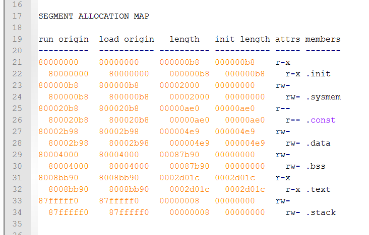

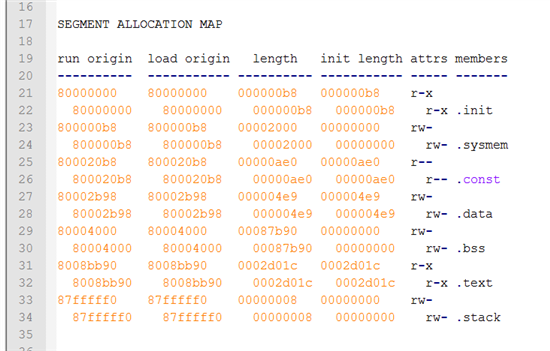

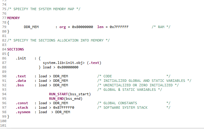

  • I can see that the settings from the linker command file are not the same as the settings in the .map file outputted by the compiler. I will try to find out why.
    Screendump of linker command file:
    Screendump of map file.

    When compiling with CCS and the TI ARM compiler there are two ways the heap size can be set:
    a) From CCS Project Properties -> Build -> ARM Linker -> Basic Options -> Heap Size for C/C++ dynamic memory allocation
    b) With a -heap directive in a linker command file. The value of a -heap directive in a linker command file overrides the value set in the CCS Project Properties.
    The linker command files for the StaterWare examples contain a -heap directive, so that value needs to be increased to allocate more heap space.
