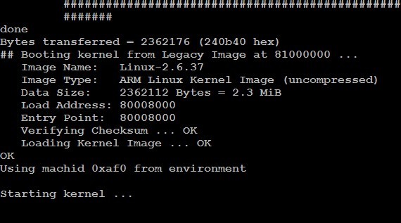

     I have try boot DM8168 custom board,and encouter some problem as illustration:
   In this condition, may I have to confirm that DDR can work regularly? DATA BUS rout is different between coustom board and EVM.If this condition could not caused by DDR,what the other condition? I'm hurry to heard from you.

    What is the SDK that you are using? Can you try with EZSDK 5.05 and provide full log file (including the u-boot messages to the console)?
    From what I can see in your screen shot, the u-boot stage is passed correctly, and the process stuck at the Linux Kernel uncompressing and booting, the next expected message is "Uncompressing Linux... done, booting the kernel."
    As you need the DDR memory initialized and working, to be able to load and run the second stage bootloader (u-boot), I can assume that the DDR can work correctly (as you pass the u-boot stage and stuck in the Linux kernel stage). This is what we have in our wiki http://processors.wiki.ti.com/index.php/TI81XX_PSP_U-Boot
    On TI81XX platform, the ROM code serves as the first stage bootloader while the U-Boot serves as the 2nd stage bootloader. The bootloader does the bare minimum configuration needed to boot the kernel and in the process relocates itself to DDR.
    The first stage (or rather the 2nd stage if the ROM code is also considered) is built using a minimal configuration and has an embedded ENV. The purpose of this stage is to initialize the necessary peripherals, especially DDR, so that a full fledged U-Boot can be transferred to DDR from NAND/SPI/SD/UART/NOR and then control passed to it.

  • Chen,
    Try the following bootargs. This is suggested by daniel
    earlyprintk debug ignore_loglevel log_buf_len=10M print_fatal_signals=1 LOGLEVEL=8
  • Chen,
    This could happens if the console argument passed on the bootargs is not matching with the UART console used in the customer board. DM8168 EVM uses "console=ttyO2" as the argument and this could be different on the customer board.
    The following wiki will help you on this http://processors.wiki.ti.com/index.php/FAQ_for_DaVinci_Linux
    Deepu Raj
