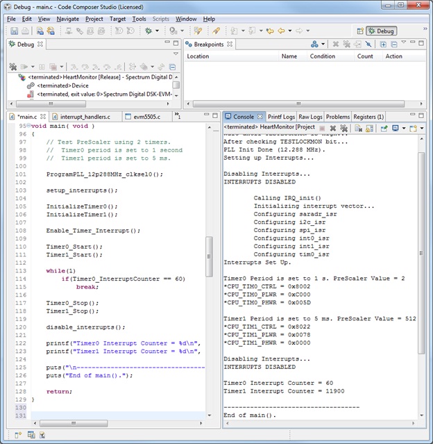

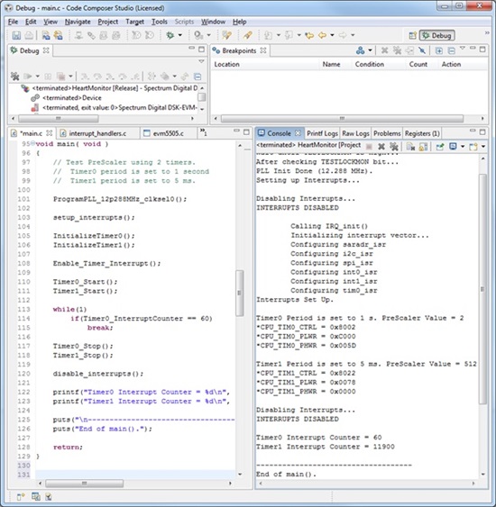

I noticed in the course of data acquisition (EVM5515 + ADS1298) the timer0 with prescaler value 512 ran slower than with prescaler value 2. The test program shows that the timer1 ran 55.5 s in 60 s determined by the timer0.
1) Is there any known issues with timer prescaling?
2) How can the system clock be tested?
3) Can TI publish timer prescaling test documentation?
