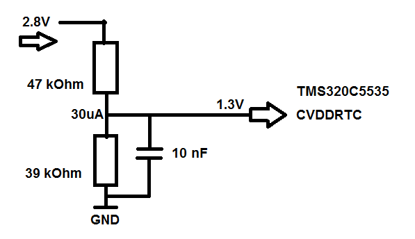

c5535 LDO not powering up - powering CVDDRTC
Already it is known, that internal LDOs will not start, if there is no power at CVDDRTC pins during powerup.
We do not use internal RTC (RTC_XO=GND,  RTC_XI=cvddrtc). Where I can found information what is maximum current draw from CVDDRTC pins in such application (required to enable internal LDO)?
in application note there is additional LDO to power CVDDRTC pins, but...
I am interested if simple resistive voltage divider will be adequate solution to power CVDDRTC pins and if all 3 LDO runs at power up then.
For example:
