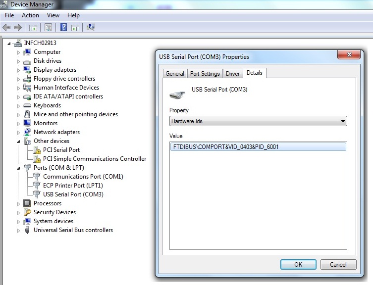

Hi, I have download the driver from http://www.ftdichip.com/Drivers/VCP.htm. But  when I install it for LCDK, it always remained me that the drive can't be installed. So I turn to the support of  FTDT, then he tell me the PID_VID is 6001&0403, if TI have changed this , the driver FTDT supplied is no longer suitable. After I check the PID_VID of FT232RQ on LCDK,  I found that they were 2303&067B. But LCDK User Guide say :"Windows and Linux drivers for the chip can be found on the FTDI Product Page ". So where can I download the driver suits to my LCDK. Thank you so much, best wishes for you!
  • Hi Libin,
    The PID/VID should have been 0x6001/0x0403. Can you send me a screen capture of the device properties like the one attached below?
    In the meanwhile, I will check on ways for you to reprogram these parameters to the correct values.
    Sunil Kamath
