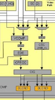

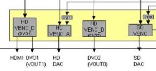

    If you look into the HDVPSS diagram, even if there are three HDVENC, there are only two video pach, which can be connected to HDVENCs. Also there are only two pixel clock source, so one of the HD VENC has to be sourced from the same clock and same path.
    We could have three independent VENC, but one of them has to be SDVENC.

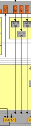

    I think the below is the two paths you meant.
    And three independent vencs?
    Accroding to the upper diagram,there are three HD VENCs(HDMI,HD DAC,DVO2),and how to ensure one of them has to be SDVENC?
    Just like the upper,can send video through this GPRX path?If so,does DM8168 can display three different video contents?

    I was saying about the output from SDVENC, you can SD VENC to get independent output.
    Yes, you can send video data in RGB format on GRPX and get three independent content..

    When i said, you can get three independent contect, i meant 2 HD video and 1 SD video (from SD VENC). RDK already supports three outputs, ie from HDMI, HDCOMP tied with DVO2 and from Sd VENC.
    You could have three independent content using grpx, but grpx supports only RGB formats and two out of three hd vencs will be running the same mode..

    Since two pipeline/path you mentioned is Main/Aux,and GPRX has its independent video path.
    There is THREE independent HD video pipelines.
    all right,there is also THREE HD independent VENCs.
    Then from the hardware view,Can display THREE independent video simultaneously?
    GRPX does not have independent video path, GRPx has independent graphics path. we cannot display YUV data on this path. so there are only two independent video path. What i said is you can use grpx to display independent content, but you will have to convert you video data in YUV format to RGB format.
