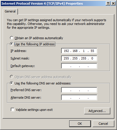

    I was able to get the out-of-box demo running on my system- here is the procedure I used (with your DIP switch settings and a direct Ethernet connection between my PC and EVM):
    (1) Configure the computer to use a static ip address:

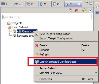

    (3)  Create an empty CCS project with a new target configuration file (be sure to include the GEL file associated with core 0):
    (4)  From the Project Explorer, double-click on the target configuration file to open the Target Configurations tab.  Right-click on your target config and select Launch Selected Configuration:

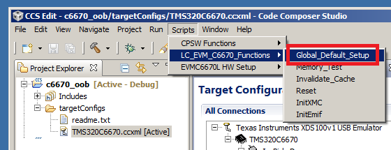

  • (6)  Before loading the program, do a Global_Default_Setup from the Scripts menu (you may notice in the console a message stating no init was done due to bootmode):
