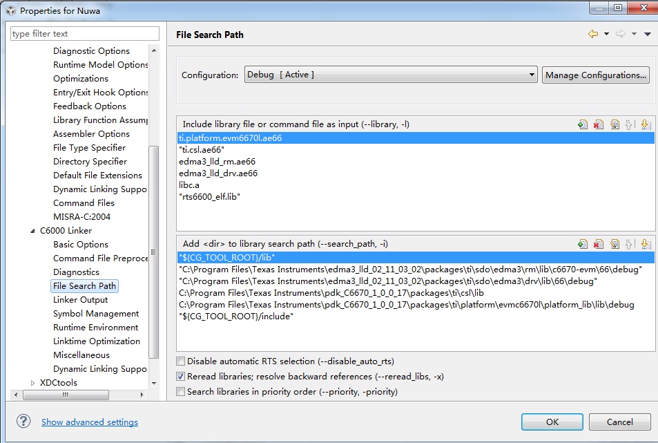

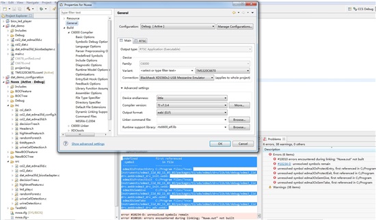

Hi, I'm trying use the EDMA3 DAT layer of the C6670 multiplecore DSP, and errors occur during the linking, says
undefined           first referenced                                                                                                                         symbol                 in file                                                                                                                             ---------           ----------------                                                                                                                        edma3OsProtectEntry C:/Program Files/Texas Instruments/edma3_lld_02_11_03_02/packages/ti/sdo/edma3/drv/lib/66/debug/edma3_lld_drv.ae66<edma3_drv_init.oe66>  edma3OsProtectExit  C:/Program Files/Texas Instruments/edma3_lld_02_11_03_02/packages/ti/sdo/edma3/drv/lib/66/debug/edma3_lld_drv.ae66<edma3_drv_init.oe66>  edma3OsSemGive      C:/Program Files/Texas Instruments/edma3_lld_02_11_03_02/packages/ti/sdo/edma3/drv/lib/66/debug/edma3_lld_drv.ae66<edma3_drv_adv.oe66>  edma3OsSemTake      C:/Program Files/Texas Instruments/edma3_lld_02_11_03_02/packages/ti/sdo/edma3/drv/lib/66/debug/edma3_lld_drv.ae66<edma3_drv_adv.oe66>
I searched the functions (edma3OsProtectExit(), edma3OsProtectEntry(), etc), find that they were defined in sample_cs.c, I tried to include this file into my project, but it brings some new problem.

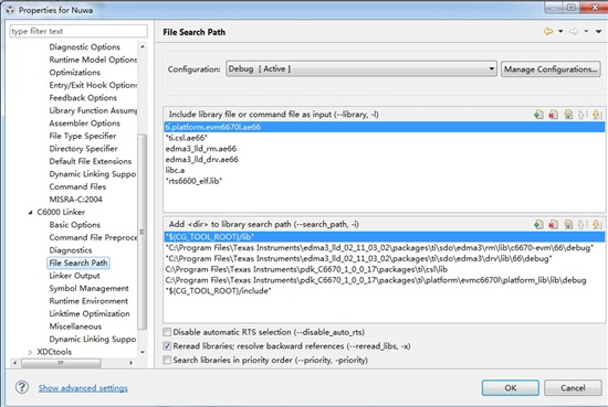

below is the project configuration (general, linker path)
I searched the previous threads and find http://e2e.ti.com/support/dsp/c6000_multi-core_dsps/f/639/p/208298/738073.aspx#738073 is talking about the same problem. But I do now see how it was resolved.
Thanks for your help.
  • In the EDMA3_RM_User_Guide.pdf, page 57/59, says there APIs should be implemented by the user, I tried the existing library edma3_lld_rm_sample.ae66 but not work ( causing some new unresolved symbols )
    Are there some short ways to make use the existing sample codes ? Thanks.
