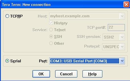

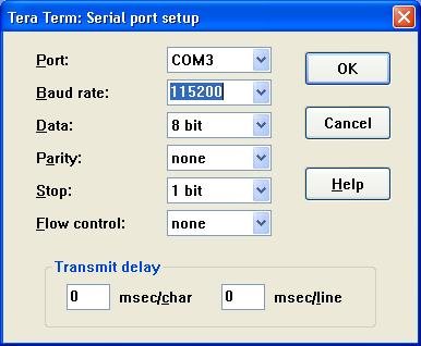

4. I opened TeraTerm and used the following configuration:

    I have also tried using the UART boot instead, like you've mentioned, but still got just a blank screen on TeraTerm.

  • No idea about NAND boot details. The UART boot should result in "BOOTME" every few seconds. The USB/Serial on J3 is bus powered, so you should be able to plug that in before you power up the board. Verify COM3 is indeed the Virtual COM port associated with USB/J3 on the board. Power up the board. LED D3 is briefly red before going green. LEDs D4-D7 should light. Sorry, that's all I got.
  • Could you explain what you mean by "Verify COM3 is indeed the Virtual COM port associated with USB/J3 on the board."
    Also, when I power up, the board, LED 3 is indeed red before going green and LEDs D4-D7 are indeed lit up.
  • When you plug in the USB/Serial/J3, a virtual COM port should appear in your Device Manager. On my PC, it is under "Port2 (COM & LPT)" -> "USB Serial Port (COM??)". My PC is pretty old, so it has some real serial ports that use up COM1 and COM2. If your PC is legacy free, the only COM port will probably be the LCDK's. That is unless you have other USB to Serial Adapters plugged in.
  • Norman,
    You're right. A separate COM port does appear, as shown in the attached screenshot in the beginning of the thread.
    Also, I just tried running the UART boot on a Windows 7 machine and it worked and does indeed show BOOTME on TeraTerm on that machine.
