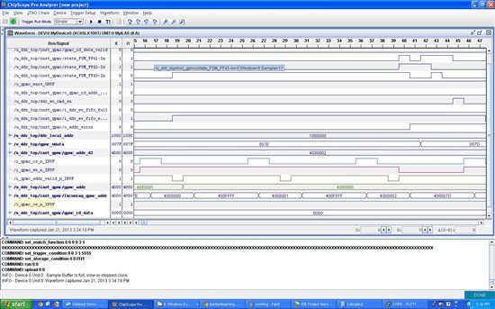

We are accessing DDR3 connected to FPGA through GPMC bus from DM8148.  We are using address/data multiplexed mode. We are seeing an unexpected  behaviour of gpmc_cs and gpmc_adv signals. I've attached the snapshot captured using Xilinx FPGA chipscope.
In the figure, following signals show the signaling issue.
 i_gpmc_cs_n_IBUF                à Chip select
i_gpmc_we_n_IBUF               à Write Enable
i_gpmc_oe_n_IBUF               à Output Enable
i_gpmc_addr_valid_n_IBUF     à Address Data Valid
 All the above signals are active low.
With the first two active chip select signals, there is no i_gpmc_we_n_IBUF or i_gpmc_oe_n_IBUF assertion. Hence there is no valid transaction which will lead to wastage of clock cycles.
 Please let us know any possible causes for this behavior of GPMC.
    The ROM Code initializes only 12 GPMC address lines (gpmc_a0 to gpmc_a11), not all 25 address lines, can this cause the issue? What address space do you intend to use?

  • Hi Vaishnavi,
    Why you are connecting DDR memory to the DM814x GPMC peripheral (through FPGA), instead of using the DM814x DDR peripheral?
    Regarding the GPMC_CSx and GPMC_ADV signals assertion, are you align with the DM814x TRM ? See :
    Figure 11-2. GPMC to 16-Bit Address/Data-Multiplexed Memory
    11.2.4.8.2.3 Address/Data-Multiplexing Interface
    For random synchronous or asynchronous memory interfacing (DEVICETYPE = 00), an address- and data-multiplexing protocol can be selected through the GPMC_CONFIG1_i[[9-8] MUXADDDATA bit (i = 0 to 5). The ADV signal must be used as the external device address latch control signal. For the associated chip-select configuration, ADV assertion and deassertion time and OE assertion time must be set to the appropriate value to meet the address latch setup/hold time requirements of the external device
    11.2.4.9 Timing Setting
    11.2.4.9.2 CS: Chip-Select Signal Control Assertion/Deassertion Time
    11.2.4.9.3 ADV_ALE: Address Valid/Address Latch Enable Signal Control Assertion/Deassertion Time
