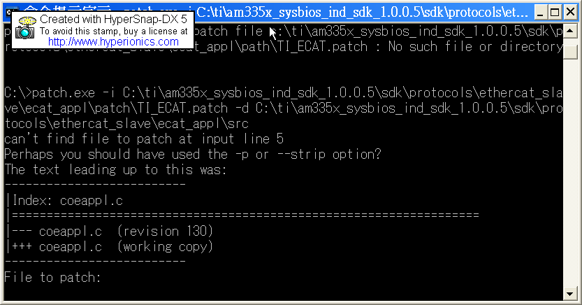

I got the source code of the "am335x_sysbios_ind_sdk_1.0.0.5" from TI site.
And I tried to run the patch utility followed "PATCH README".
But I got some fails as the below.
Please let me know how to solve this issue.

Hello Shian,
I see that your are trying to apply patches on files stored in folder named "src". This seems to be the problem. EtherCAT source files are expected in "EcatStack", not in "src".
Copy EtherCAT sources from ETG to "EcatStack" and then try once again.
