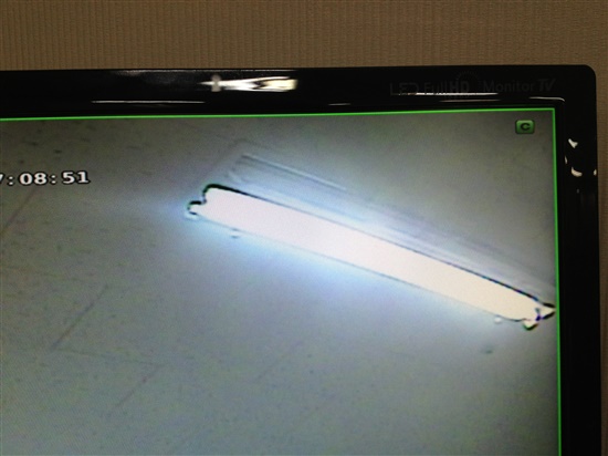

Hi
i have a issue about image quality issue(line is blocked ) .  i guess this is a lowcostScaling issue.
but lowcostscaling is setted FALSE. i tested this dvr_rdk_demo_mcfw(RDK_03.50) , progressive mode, HDMI xga resolution.
i checked console log .
7536.201301241812.txt

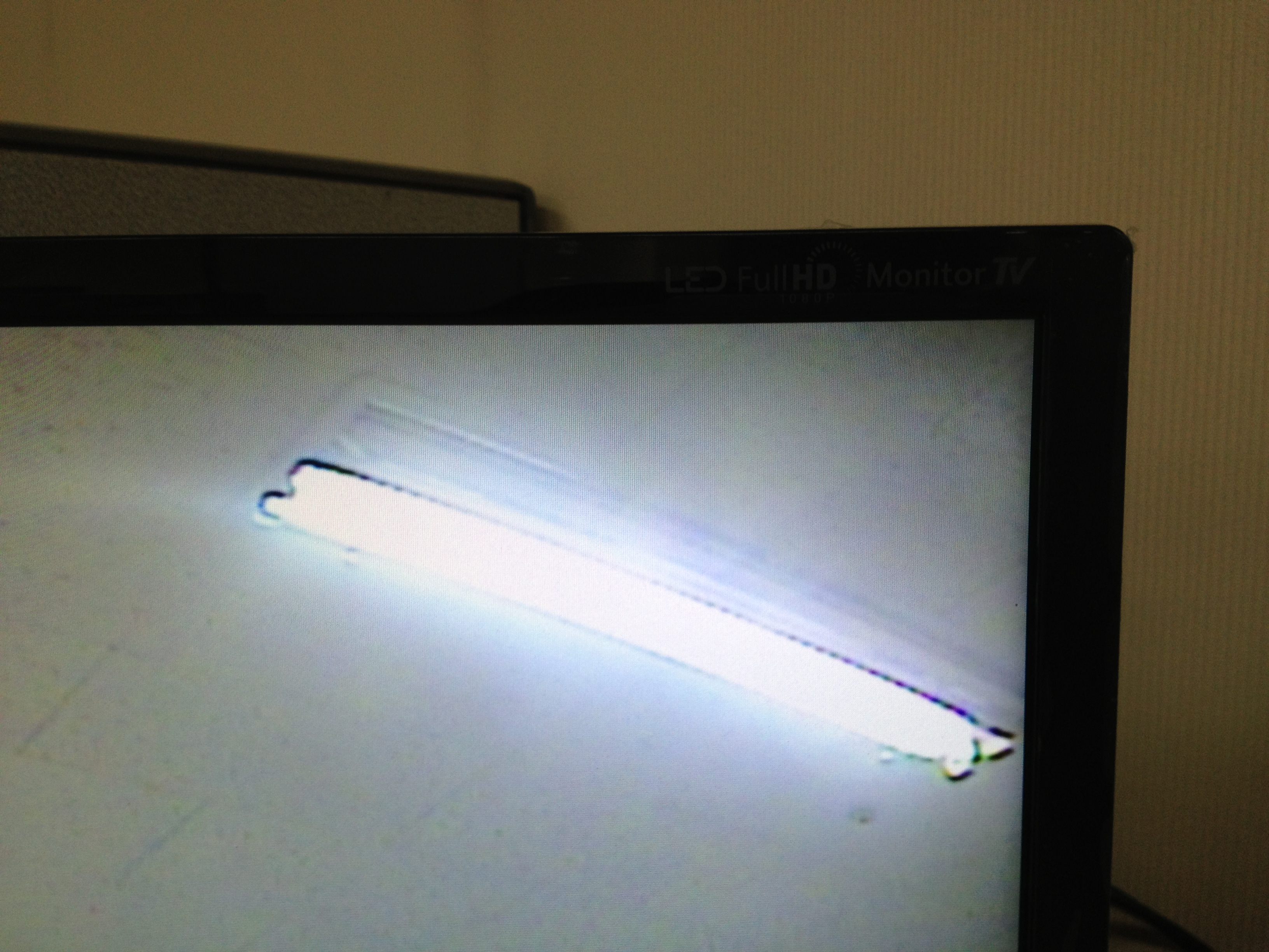

i have more images but upload two images (the same monitor)
do you know why image quality is more not good?
1.  DVRRDK_03.50.xx ( fluorescent light line is blocked)
2. DVRRDK_03.00 (fluorescent light line is smooth)
Best Regards.
  • Are you seeing the quality issue with all layouts or only 4x4 layout.
    as i attached my log. above image is LAYOUT_1CH live screen .
    log file is captured data at the moment when i see that issue.
    and LAYOUT_4CH is not shown that issue.

    Can you print the complete log? i want to check the coefficients used for this factor..
    Brijesh Jadav
  • Hi.
    it's my console log , do you want to another log?
    Regards. CHO
  • Are you seeing the saw tooth edge when commenting out
    /dvr_rdk/mcfw/src_linux/mcfw_api/usecases/ti816x/multich_progressive_vcap_venc_vdec_vdis.c
    gVdisModuleContext.setMosaicFxn     = MultiCh_progressiveDVRSetMosaicParams;
    also ?
    Another thing is are you seeing the artifacts for all channels .Mainly is there difference between channel 0 -7 and channel 8 - 15 ?

  • Hi.
    Thank you for your reply. i checked two things. but there's nothing changed.
    i wondering you can not see this issue? this issue seen only for me?
    1.
    //gVdisModuleContext.setMosaicFxn     = MultiCh_progressiveDVRSetMosaicParams;
    2. One more test is change /dvr_rdk/mcfw/src_bios6/links_m3vpss/swMs/swMsLink_drv.c
