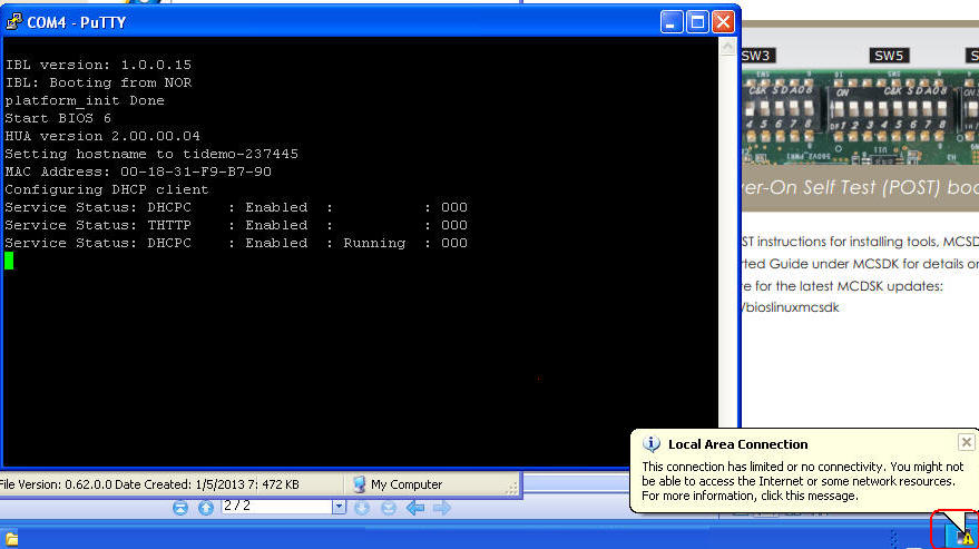

 1 When I did the OOB test and configured the IP address with DHCP mode, the EVM board could not get an IP address. Can I solve this problem?

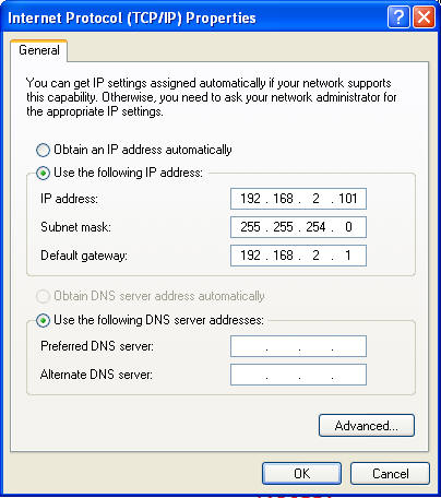

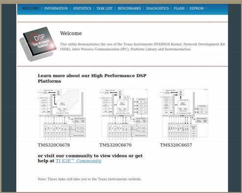

2 So I configured the EVM board with the Static IP address in the following way, and I could access to the following webpage.
3 Base on 2, I want to do the EMAC boot test. In this situation, what’s the IP address of the EVM board?
