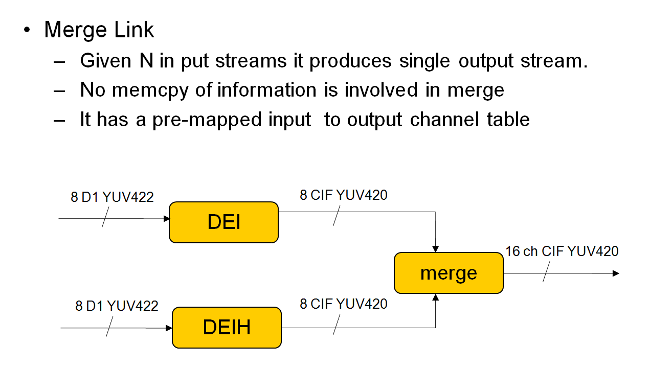

  •    Q1. how do we know the fps for each DEI_SC/VIP_SC port in DEI module?
             In Vsys_printDetailedStatistics in DEI Statistics
        - Out[0] FPS - DEI_SC FPS
        - Out[1] FPS - VIP_SC FPS
      Q2. how do we know the fps for each output port of CIF_DUP_LINK?
       - Dup link input fps will be same as output fps. You have to check the fps in the next link in the chain.
       in case of multich_progressive_vcap_venc_vdec_vdis.c, CIF_DUP_LINK -> IPC FrameOut -> IPC FrameIn -> SCD.
       we can say the following statistics is for the above link. Right?
       [m3vpss ]  *** IpcFramesOutRTOS Statistics ***
       if yes, how do we know the fps of link like  "IPC FrameOut -> IPC FrameIn -> EncLink"?
       is it the following?
       [m3video]  *** ENCODE Statistics ***
