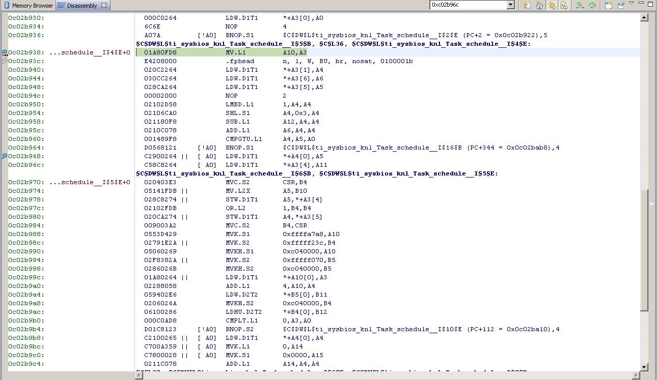

    Look at the disassembly window at that address.   Also look at the disassembly window at the address pointed to by B3 register (this would be where it Branched from in the last function call.)  If you can do a screen shot of the disassembly windows w/ about 10 instructions before and after these addresses, we can take a look.

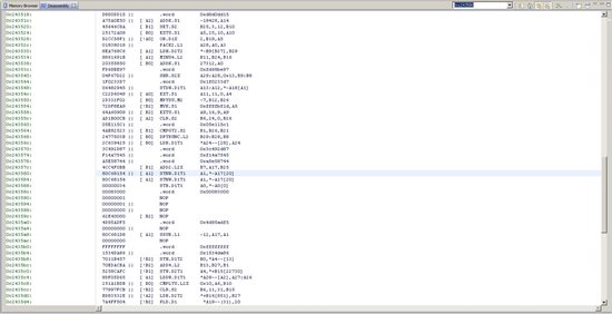

    thank you for the fast answer. I really though that it is stack overflow.
    I take a image of the disassemble code in this address area. I hope that could help you. You can found it in the attachment.
  • Was this capture after it failed or was it after a fresh load and run?  I see a breakpoint so I suspect it would have been after a fresh load and run.
    I'll need the capture after the failure to see if we have memory corruption (being overwritten.)
    Also, grab a capture at the IRP (0xC003E54)
    Another look at this, I see that the Exception is actually at 0x0.  I should have noticed that before.  That's the address it tried to branch and execute from.  There is no valid memory there.  This goes along with my earlier theory of an uninitialized variable possibly causing the issue.
    Chad
    oh sorry the capture was after fresh run. I try to get the same error, but I get others.

  • Yeah, that appears to be garbage info there.  Do you have the .map file from the build?  Let's see if this is supposed to actually be the code space or not with it.
