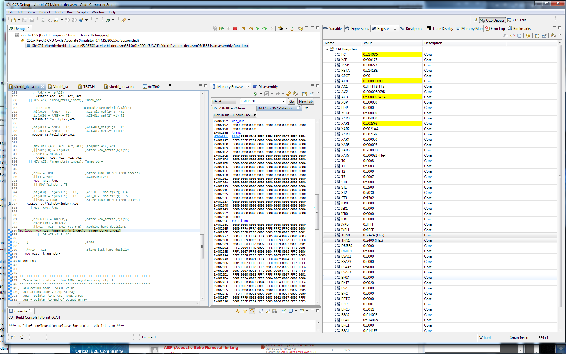

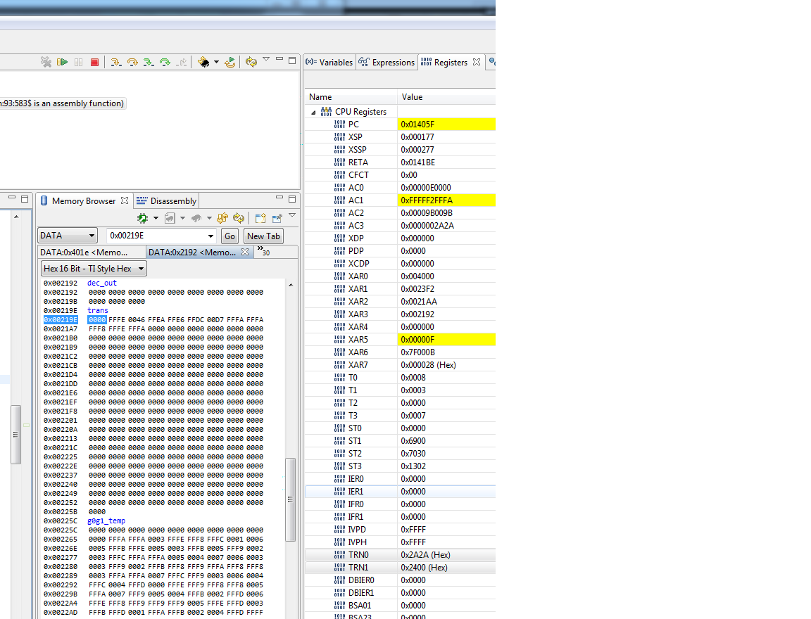

When I debug my code, there are several questions I cannot find the answers. In the following figure, when I stop at line 327, it seems to me that AC1 and AC3 should have the same results as TRN1 and TRN0 (by *AR6 and *AR7 as the comment says). In fact, AC3 is the same with TRN0, but AC1(ignore high 6 bits. fff2h) is not the same with TRN1(2400h). At the XAR6 address(7f000b) content is that of TRN1, i.e. 2400h. At the XAR7 address(000028h) the content is that of TRN0, i.e.2A2Ah.
Then the logic of line 336 is the combination of AC1 and AC3 after AC3 left rotation 8 bits. But either with the TRN0, TRN1, or AC1, AC3, I cannot get the result of FFFA in AC1 after the bits combination. What is the problem with the unexpected results?

    AC1 register has the data of TRN1? In the register window when debug, AC1 content is not that of TRN1.

    In my debug process, AC3 does have the same content of TRN0. Why are there different results for the above similar line execution?

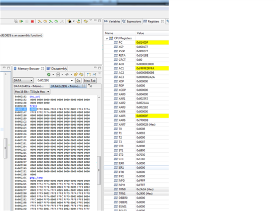

    spra776a.pdf title is for TMS320C55xx DSP. I suppose it can apply to TMS320VC5505 DSP because I have its document on the computer. This doc said that the first 192 bytes is for MMR. Then, I check AR7 content is 0x000028, which is in the range of 192 byte. AC3 does have the same content of TRN0. AR6 is 0x7f000b, which is out of range 192 byte. AC1 has different content of TRN1.

    AR6 has content: 0x7f000b. This has problems with MMR?
    When I check in disassembly window, I find that AR6 is 0x7FFFFF before
    MOV #AC1_L, AR6 ;Absolute date memory access to MMR
    MOV #AC3_L, AR7 ;register. AR6 points to AC1 and AR7 ;points to AC3
    At disassembly window, it has this format:
    MOV #11, AR6 ;
    MOV #40, AR7 ;
    It seems that the first 8 bits (0x7F) are segment like thing. Does it care or not in MMR of AC1 usage? (It has to reset to 0x00?)

    is not a memory access.  It strictly loads the MMR address of AC1_L into the register AR6.  AR6 is the 16-bit portion of the 23-bit register XAR6.  The instruction you've used is a 16-bit execute-phase register move, so it cannot modify the upper bits of XAR6, which it leaves alone.  You must either take care to clear the upper bits of XAR6 before this instruction, or use the appropriate address-phase move instead.  One way to do this would be with this instruction:
    AMOV #AC1_L, XAR6
    However, none of this explains why the upper bits of XAR6 were non-zero to begin with.  Are you using large memory model?
    I do not need large memory model. Your answer solves the proble. Thanks.
