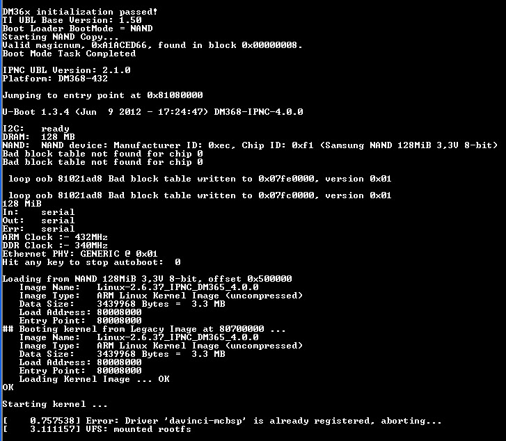

Dear,
I am working with DM368 IPNC and ver 4 Software. I am using appro IPNC DM368IPNC-MT5 A187 and try to burn the software for it but I got the error during booting. Please see the below image for detail. The boot process just go to mounted rootfs and stop there.
I wonder that why the V4 look like difficult for burning than the previous versions. It is grateful to have your help.

    Firstly, we have v4.1 which is the latest version, if you are starting on 2.6.37 kernel version. We suggest you start form this version
    For the error you are getting, it looks like you have not erased the NAND before burning binaries. As we have chnaged the NAND confi, you need run NAND SCRUB while migrating to v4.x releases.
    This is available at Appro ftp site or contact TI local sales/FAE for this
    Please send us the complete log by removing 'quiet' from bootargs as this will mask the boot logs
    Also, try burning the binaries from CCS once as this will erase the complete NAND before burning new v4.x binaries

  • Dear,
    I have tried the v4.1 on our appro camera. It worked for the binary files which supplied by RDK package but after we compile and use our owned binary files some errors happened. Please see the log for detail:
    DM36x initialization passed!
    TI UBL Base Version: 1.50
    Boot Loader BootMode = NAND
    Starting NAND Copy...
    Valid magicnum, 0xA1ACED66, found in block 0x00000008.
    Boot Mode Task Completed
    IPNC UBL Version: 2.1.0
    Platform: DM368-432
    Jumping to entry point at 0x81080000
    U-Boot 1.3.4 (Jan 29 2013 - 21:09:36) DM368-IPNC-4.1.0
    I2C: ready
    DRAM: 128 MB
    NAND: NAND device: Manufacturer ID: 0xec, Chip ID: 0xf1 (Samsung NAND 128MiB 3,3V 8-bit)
    Bad block table not found for chip 0
    loop oob 81021ad8 Bad block table written to 0x07fe0000, version 0x01
    loop oob 81021ad8 Bad block table written to 0x07fc0000, version 0x01
    128 MiB

    Hit any key to stop autoboot: 0
    Loading from NAND 128MiB 3,3V 8-bit, offset 0x500000
    Image Name: Linux-2.6.37_IPNC_DM365_4.1.0
    Image Type: ARM Linux Kernel Image (uncompressed)
    Data Size: 3439968 Bytes = 3.3 MB
    Load Address: 80008000
    Entry Point: 80008000
    ## Booting kernel from Legacy Image at 80700000 ...
    Loading Kernel Image ... OK
    OK
    Starting kernel ...

    [ 1.614444] net eth0: attached PHY driver [Generic PHY] (mii_bus:phy_addr=0:01, id=181b8b0)
    [ 1.640373] Sending DHCP requests .
    [ 3.610404] PHY: 0:01 - Link is Up - 100/Full
    [ 3.740075] ..,. OK
    [ 13.870167] IP-Config: Got DHCP answer from 0.0.0.0, my address is 192.168.0.93
    [ 13.878027] IP-Config: Complete:
    [ 13.881189] device=eth0, addr=192.168.0.93, mask=255.255.255.0, gw=192.168.0.1,
    [ 13.888892] host=192.168.0.93, domain=, nis-domain=(none),
    [ 13.894880] bootserver=0.0.0.0, rootserver=0.0.0.0, rootpath=
    [ 14.012753] UBIFS: mounted UBI device 0, volume 0, name "rootfs"
    [ 14.018789] UBIFS: file system size: 38473728 bytes (37572 KiB, 36 MiB, 303 LEBs)
    [ 14.026545] UBIFS: journal size: 5332992 bytes (5208 KiB, 5 MiB, 42 LEBs)
    [ 14.033928] UBIFS: media format: w4/r0 (latest is w4/r0)
    [ 14.039768] UBIFS: default compressor: lzo
    [ 14.043923] UBIFS: reserved for root: 0 bytes (0 KiB)
    [ 14.051824] VFS: Mounted root (ubifs filesystem) on device 0:12.
    [ 14.057989] Freeing init memory: 128K
    [ 15.163886] davinci_mmc davinci_mmc.0: Using DMA, 4-bit mode
    [ 15.291285] Loading iSCSI transport class v2.0-870.
    [ 15.584095] iscsi: registered transport (tcp)
    [ 15.657964] musb-hdrc: version 6.0, peripheral, debug=0
    [ 15.734067] musb-hdrc musb-hdrc: dma type: dma-cppi3
    [ 15.761071] musb-hdrc musb-hdrc: USB Peripheral mode controller at fec64000 using DMA, IRQ 12
    [ 15.876439] loop: module loaded
    [ 15.946907] tun: Universal TUN/TAP device driver, 1.6
    [ 15.952210] tun: (C) 1999-2004 Max Krasnyansky <maxk@qualcomm.com>
    [ 16.006490] console [netcon0] enabled
    [ 16.010402] netconsole: network logging started
    [ 16.097513] PPP generic driver version 2.4.2
    [ 16.127665] PPP Deflate Compression module registered
    the booting process was stopped here. I guess something wrong stay in the mtd_utils or ubifs file system. Do you have any idear about that.
    I also attached the configure information for bootarg and boot command below:
    Platform: DM368-432
    I2C: ready
    DRAM: 128 MB
    128 MiB
    In: serial
    Out: serial
    Err: serial
    ARM Clock :- 432MHz
    DDR Clock :- 340MHz
    Ethernet PHY: GENERIC @ 0x01
    DM368 IPNC :>print
    bootdelay=4
    baudrate=115200
    bootfile="uImage"
    serverip=192.168.0.41
    ipaddr=192.168.0.124
    ethaddr=00:EA:AD:EF:ED:FE
    gatewayip=192.168.0.1
    dnsip=192.168.0.1
    dnsip2=192.168.0.1
    netmask=255.255.255.0
    bootcmd=nboot 0x80700000 0 0x500000;bootm 0x80700000
    bootargs=mem=48M console=ttyS1,115200n8 noinitrd ip=dhcp rw ubi.mtd=3,2048 rootfstype=ubifs root=ubi0:rootfs cmemk.phys_start=0x83000000 cmemk.phys_end=0x88000000 cmemk.phys_start_1=0x00001000 cmemk.phys_end_1=0x00008000 cmemk.pools_1=1x28672 cmemk.allowOverlap=1 cmemk.useHeapIfPoolUnavailable=1 nohz=off highres=off clocksource=acpi_pm lpj=1077248 eth=00:0c:0c:a0:09:EC
    verify=no
    stdin=serial
    stdout=serial
    stderr=serial
    ver=U-Boot 1.3.4 (Jan 29 2013 - 21:09:36) DM368-IPNC-4.1.0
    Environment size: 731/131068 bytes
    DM368 IPNC :>
    I have already scrub nand everytime I burned new file system:
    nand scrub 0x900000 0x7700000;mw.b 0x82000000 0xFF 0x1800000
    tftpboot 0x82000000 ipnc_dm368_ubifs;nand erase 0x900000 0x1800000;nand write 0x82000000 0x900000 0x1800000
