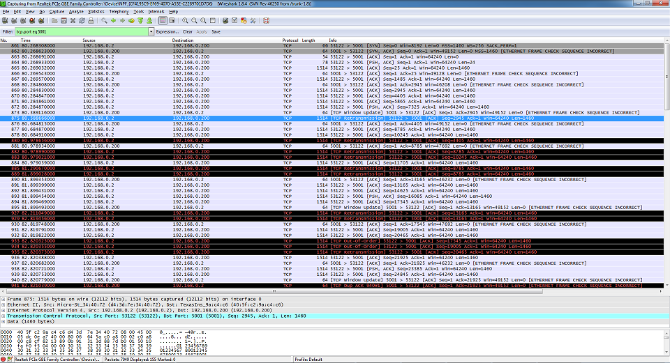

We just have started with the C6678 EVM and the first task is to verify that our system design is viable. We are going to use C6678 DSP for intensive real-time data processing. In our system we receive raw sensor data via Ethernet (connected internally in chassis) then process it and send the results via a second Ethernet port. Actually our target throughput on input is quite low: near about 70 Mbit/s (but we really need a lot of computation power).
We are now experimenting with the NDK and our test bench is based on the 'Client' example and iperf. We slightly modified the example so that it could serve as a server for iperf (modified client.c is attached). Please note that for now we are interested only in NDK throughput so we use non-copy (SOCK_STREAMNC) sockets.
So far so good. Our NDK application works (wow!) but the results are a bit frustrating: measured throughput is as low as ~1Mbit/s and even this throughput is not stable. Here's a sample of the iperf client output:

And here's a sample screenshot of Wireshark:
(zipped .pcap log is attached as well). For completeness, tcp, ip and GbE stats are given below.
We've spent a couple of days investigating the problem and found that NDK feels bad when MSS value is greater than ~1KByte (Iperf allows to explicitly define MSS but it does not work in Windows, so we simply change MTU setting for the connection):

When this happened NDK we always have ~100-200Kbit/s throughput and only reboot helps

  • Hi, Dimitry.
    How about try this?
        int   i =1;
        setsockopt( s, IPPROTO_TCP, TCP_NODELAY, &i, 4 );
    In your DSP program.
    Or change some socket options in your host program.
    I hope it will help you.
    -Kazunori.
  • Dear Kazunori,
    In our tests DSP acts as a receiver, it only sends TCP ACK's. I believe TCP_NODELAY is meaningless here.
    Cheers,
    Dmitry
  • Dear Korenev
    We have exactly the same problem you have encountered! We can have NDK run on our c6678 board but its TCP is way too slow and not stable. I was wondering that did you find the solution to this? or we can work together on this problem.
  • Dear Fan Zhang
    We haven't found any solution yet. According to our dev plan we investigate the issue in July
    Dmitry
  • Dear TI employees,
    In the meanwhile we have tested the following combinations of development kits:
    1) CCS 5.0.3 + XDCTools 3.22.04.46 + BIOS 6.32.05.54 + PDK 1.0.0.17 + NDK 2.20.04.26 - our original setup
    2) CCS 5.0.3 + XDCTools 3.24.04.60 + BIOS 6.33.06.50 + PDK 1.1.2.6 + NDK 2.21.01.38
    3) CCS 5.4 + XDCTools 3.25.00.48 + BIOS 6.35.01.29 + PDK 1.1.2.6 + NDK 2.22.03.20
    The net result is the same - TCP receive doesn't work on our C6678 EVM and we have no idea why (It should be noted that TCP send seems to work OK). We have read a lot of related posts on this forum but unfortunately we have not seen any complete solution. Sometimes the problem magically disappears, the other times the topics just die out.
    Could anyone help us with it? Really, some crazy guys around me are going to port uip/lwip/some-other-stack-implementation (and they argue that the code is far more clear and reliable) just to continue active development of the project. It's ridiculous, isn't it?
    Looking forward to your reply,
    Dmitry
  • Dears,
    We have hacked this bull *** and now it works.
    In order to locate the problem we have recompiled and debugged the whole NDK stack and the NIMU driver. I should say IMHO NDK stack code is a bit "dirty" but it's straightforward and it doesn't get too much time to understand its internal details.
    On the contrary, the NIMU driver is an evil. Actually the bug was described earlier by Ralf Goebel here: http://e2e.ti.com/support/dsp/c6000_multi-core_dsps/f/639/p/214649/762847.aspx. We have patched the NIMU driver with CSL_XMC_invalidatePrefetchBuffer() calls and now it works. I believe the NIMU driver has a lot of other bugs (here is an example: Add_MACAddress() calls Osal_nimuFree() twice whenever PA timeout occurs).
    In release we have ~350Mpbs (TCP, no-copy socket) and it works for at least 14 hours (we have not yet performed longer tests). We have also checked that incoming data are not corrupted.
    Dmitry
    EDIT: Actually we have >850Mbps with properly set up TCP window size
  • hi Dmitry Korenev
    we are facing the same problem, can you state some more detail on how you solved this? Whrer in NIMU driver should I call CSL_XMC_invalidatePrefetchBuffer()
    Thanks a lot
  • Hi yu fei,
    We've made a lot of fixes in NIMU. Attached you can find source from our repo. It's based on PDK 1.1.2.6, just compare nimu_etc.c with vanilla one.
    We actually decided not to use CSL functions and instead simply use SYS/BIOS Cache API (note that NIMU already uses SYS/BIOS APIs anyway).
    We also decided to directly setup Hwi without EventCombiner (c.f. my post http://e2e.ti.com/support/dsp/c6000_multi-core_dsps/f/639/p/270499/1026017.aspx#1026017)
    4130.nimu.zip
    Dmitry
  • Thanks a lot, it's so generous of you!
