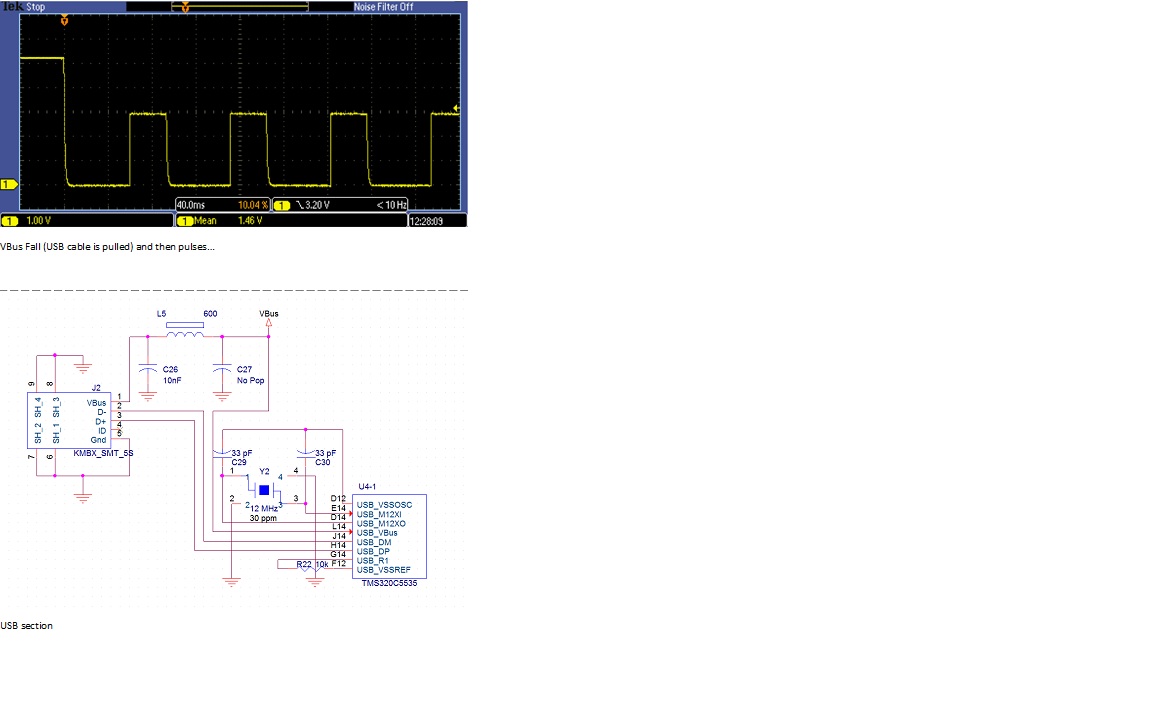

    I did some more tests. One problem came from a diode leakage that prevented the VBus from going all the way down to zero when the cable was disconnected. It came to between 2 and 3V, depending on the board temperature. After realizing that, I did two additional tests:
    - The first test was to cool-down the diode in order to reduce the leakage. This in turn allowed the VBUS voltage to go down to zero in a controlled manner, as a function of temperature. What I found out is that the DEVCTL register stays at 0x0099 (indicating "Above VBUS Valid") until the VBUS voltage goes below 1.5V...! At this point DEVCTL reads 0x0090, which indicates "Above A-Valid, Below VBUS Valid". When VBUS rises to above 3V the DEVCTL stays at 0x0090. It only switches back to 0x0099 when the VBus voltage is close to 5V. In other words there seems to be a HUGE hysteresis...
    Is that normal? I would have expected an hysteresis of at most 100 mV. A Hysteresis of more than 3V seems very abnormal, and to defeat the purpose of this input!
    - The second test that I did was to place a 10k pull-down between VBus and ground, to force the voltage to drop lower, despite the diode leakage. A 10k pull down on VBus should not pose any problem. In that situation I find the strangest behaviour:
     1) Everything seems normal with respect to USB communications when VBUS is present.
     2) When VBUS is removed, the VBUS voltage first drops to a few hundred mV, as it should. Then it pulses at 2.8V, for 32.8 ms, every 91 ms, as if VBUS was driving the bus...!
    I have not found anything documented that could explain either the large hysteresis or the behaviour when a pull-down is added on VBUS.
    Is there anything to explain that?

    Is it possible that you can share the USB portion of the schematic (in pdf) and scope capture with me?
    David

    I have no problem insuring that the VBUS rise time is short and <100ms. However the fall time depends on the amount of capacitance on the pin and the value of the resistive pull-down if any. A low resistive pull-down is not possible as I explained earlier because it would drain VBUS current in suspend, which might be in excess of what the USB spec allows. We therefore may have to live with a slow fall time, and as I showed earlier the VBUS detection logic does not seem to work properly during a slow fall either...
    I added the JPG below. In this case, the capacitor C27 has been replaced by a 100k resistor in order to shorten the fall time and insure a return to 0V. Otherwise the pin is completely floating and may not fall all the way to zero. Let me know if you would prefer a pdf showing the same.I could not find any way to upload a pdf.
  • Bruno
    The SESSION bit is read/writable, are you writing to register address 0x8461h?
    I took a look at the schematic, and the USB interface implementation looks correct. Two experiemnts I would suggest:

    The diode is not shown on the diagram that I sent, and indeed it was removed for the latest tests that I did (my previous message). So the schematic IS representative of the actual USB input configuration during the latest tests. There is no more diode leakage because there is no more diode. However the behaviour is what I described when the VBUS falls slowly (VBUS level only switches from 11 to 01 when VBUS falls below 1.4V. The code never goes through 10. The code never goes to 00, even if VBUS goes down to 0V.

    On the problem #2, I don't see a reason why the VBUS bits are not getting updated. Are you doing multiple reads once the VBUS voltage reaches above 4.4V? Is the USB in its normal mode?

    There is a register called SRPFIXTIME register. If the transition from SESVALID to VBUSVALID happens in the time frame defined by this register, you would never see the transition state. Would you please modify the time frame defined by this register and then see if you can observe the transition state?
