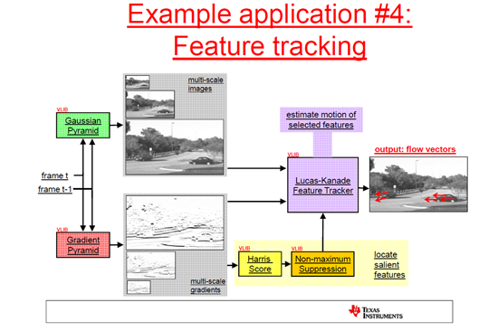

I try to create program for feature tracking. I took the idea from the picture:
My code of program is:

Now the problem is when I process the GsPyramidOld(this is image at t - 1) some of the value in fpnX[] and fpnY[] array become negative after calling VLIB_trackFeaturesLucasKanade_7x7 function.
My question is why these values may be negative ? How to overcome this problem ?
