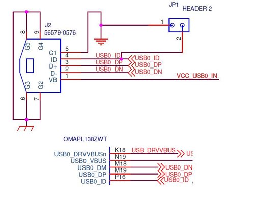

I'm able to compile and run the Usb_Dev_Bulk from OMAPL138_StarterWare_1_10_03_03 using CCS-v5.1 on TMDXLCDK138 (OMAP-L138 Development Kit (LCDK)).
But my Win XP SP3 does not able to detect the USB device correctly.
The steps of set up are below:
1) Debug the Usb_Dev_Bulk Project on the Device.
2) Windows XP SP3 detect it and name it "Unknown Device" under USB controller.
3) Try to download and install inf file from http://www.ti.com/tool/sw-usb-windrivers but still unable to install the driver.
Please advise what to debug/check/change?
Thank you very much.

    This sort of thing is tough to debug. First step would be to see if any part of the enumeration succeeded. If the Device Manager entry for "Unknown Device" has a 0 VID and PID then enumeration failed. But it should have succeeded enough to match the VID/PID in the INF file. Puzzling. Another tool to see enumeraton values is UVCView. Microsoft used to offer UVCView as a separate download. It's now bundled up in the DDK/WDK. Another is "Thesycon USB Descriptor Dumper" at: http://www.thesycon.de/eng/usb_descriptordumper.shtml
    Maybe try a Uninstall/Install with a different cable. Very tough to debug without a USB sniffer like USB Explorer.

  • Hi Norman,
    With USB TDD tool, the error log is attached.
    Information for device USB\Vendor_1CBE_Product_0003:
    Connection Information:
    Connection status: Device failed enumeration
    Device actual bus speed: Low
    Device is hub: No
    Device adress: 0x0000
    Current configuration value: 0x00
    Number of open pipes: 0
    Device Descriptor:

    Does the "LibUsb-win32" as recommended by Duy-Ky Nguyen88210 help for this? How to use this driver?
    Thank you.
  • WinUSB and libusb32 are both minimal USB drivers. They provide plain bulk endpoints to transfer data. In Windows, the endpoints would look like special files. The CDC Serial layers add extra functionality that make the bulk endpoint look like a COM port. The CDC, MSC, and HID classes  are nice as they don't usually require driver installation. But they are much more complicated, usually slower and may be a unsuitable model.
    The libusb32 stack was created quite a while ago. I remember using it in linux 2.4 as USB device and USB Host on Windows. It is open source for device and host side. I believe compiled driver binaries are available for Windows. Using libusb32 will usually require installation of the driver file and an INF file. Refer to Duy-Ky Nguyen88210's thread on how to use libusb32. I've never used libusb32 in this situation.
    WinUSB appears to be Microsoft's answer to libusb32. I think it appeared after Windows XP. On Windows newer than XP, the driver should installed as part of the OS. An INF file should be all that is required to associated the device with the WinUSB driver.
    Your USB TDD tool output looks like it got part-way though the enumeration process. The VID(0x1CBE) and PID(0x0003) look good. No idea why enumeration did not proceed further. Check those descriptor values against those in the dev bulk source code. I don't have access to my development system to check at the moment.
    Maybe try some of the other USB DEV examples, like HID or MSC. Maybe try on the DSP rather than the ARM side of the OMAP-L138.

    I think I almost found the problem.
    From LCDK eval kit schematic in attached print screen ( ), USB0_ID pin of OMAPL138 IC always connected to USB_ID pin of USB OTG connector. From Table 35-3. USB Terminal Functions of OMAP-L138 DSP+ARM Processor Technical Reference Manual, for OTG mode or device only mode of operation,do NOT connect the USB0_ID pin, that is, leave the pin floating.
    Could you confirm that for USB0_ID pin of OMAPL138 must let it float?
    Thank you.
  • On my LCDK-C6748 board, JP1 is open. I came out of the box that way. As such, the cable determines the role. The cable that I using has that pin floating. I would guess that floating means the device role.
    I think JP1 should be shorted only if you want host role and your cable doesn't ground the pin for you. Handy since very few female A to male minB cables do that.
